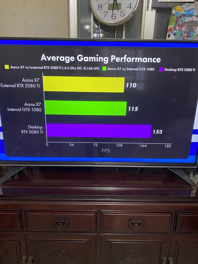

Yes and no. These are the benchmarks from running it on a 2019 5K iMac.

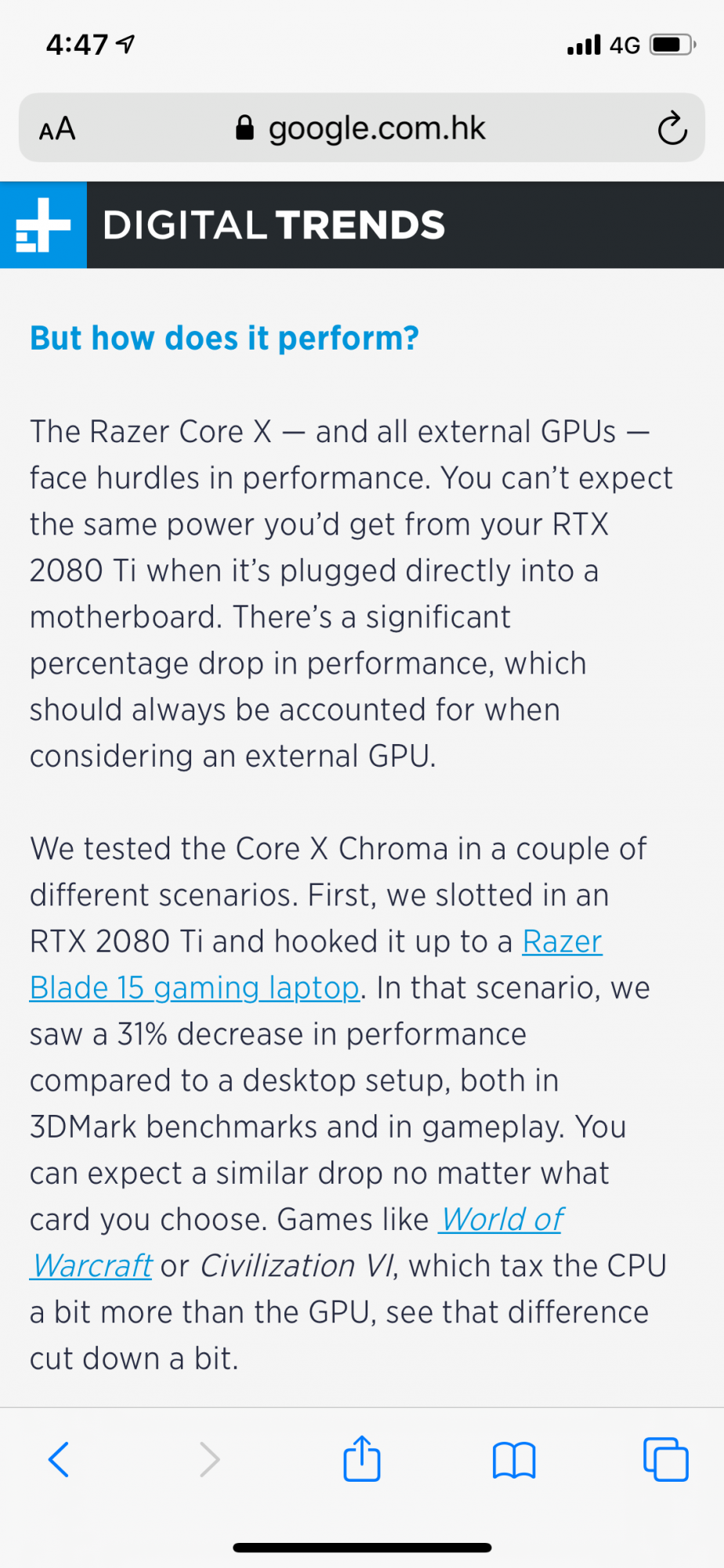

planned to get the Razer core x with RTX 2080ti, but hesitated after reading an article which said there is much 31% performance drop than those desktop setups
is it a hardware problem or software or alleviated any in recently?

I had no problems with sleep. But yes, there’s definitively a performance loss using thunderbolt 3. How much the loss is will depend on your application.
for gaming , there is about 30% drop on performance using imac's display over desktop set up?
