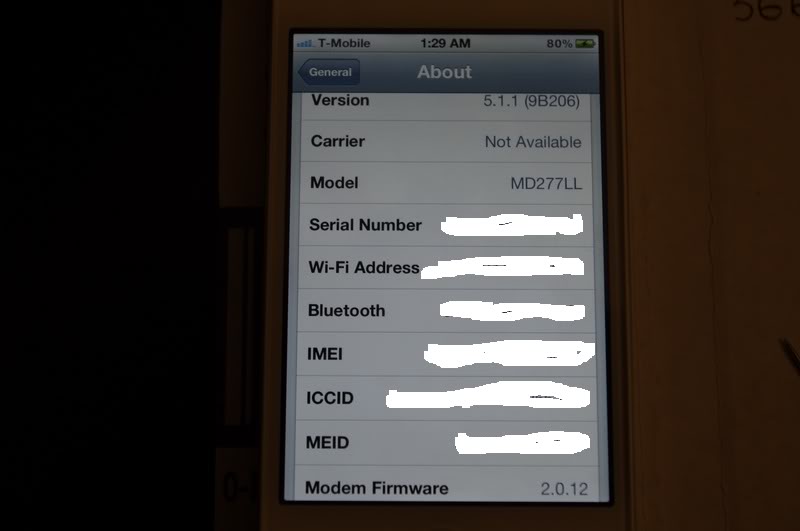

XenonXTZ
macrumors newbie
May 25, 2012
7
Holy ****!
Dude, you are the best, the life saver!
WORKED!!! This **** worked, I swear!!!
I'm posting a screenshot of my Verizon 4s running 5.1.1 BB 2.0.12

Holy ****!
