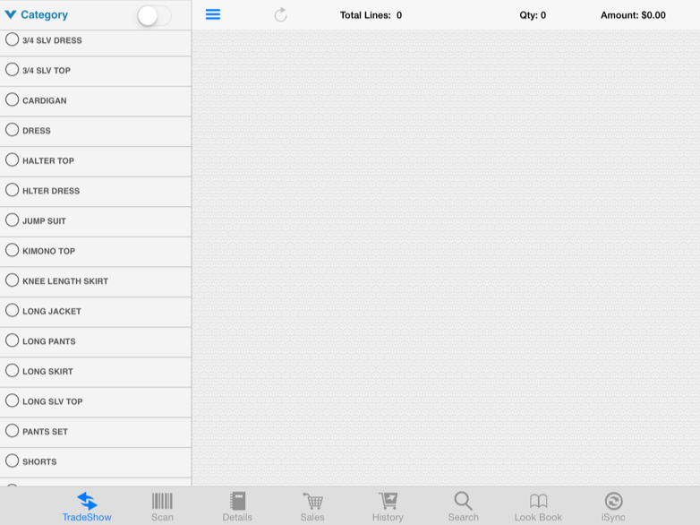

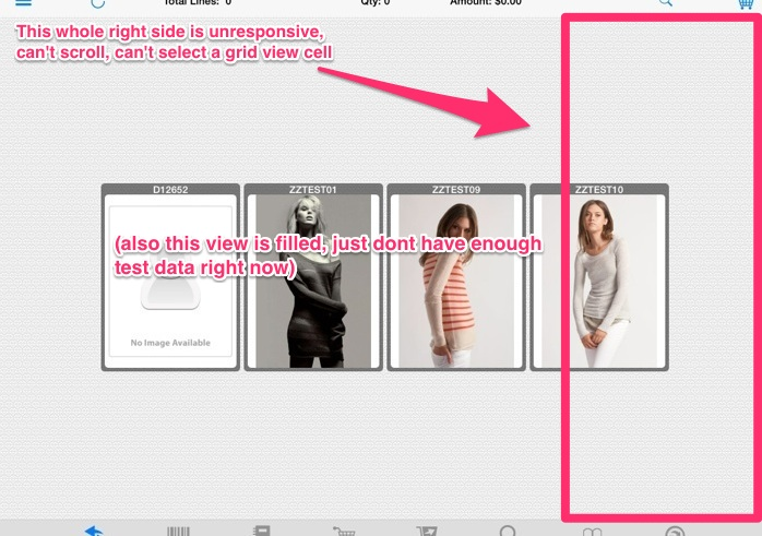

Ever since iOS7, when starting my app in landscape mode, the right part of the grid view is not responsive (can't scroll up and down in the area nor can i select a item). Pretty much a quarter of the screen up and down.

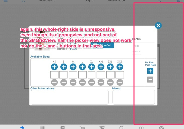

Not only that, when you select an item a pop up view comes up, and even when in the popup view comes up (which is not part of the GMGridView) it's still not responsive in the same area.

Is the area the IS responsive 768 points wide, by any chance? It looks to me like the clickable part of the window is somehow locked to portrait width, and when you rotate to landscape, it doesn't get wider.
In your second screen-shot, is are the + and - buttons part of the grid-view, or are they separate controls in your view controller? If they are not part of/contained by the grid view then that suggests the problem is not with the grid view but a more global problem with your view controller.''

ok, so after getting rid of the grid view and among other 100s of things.
when i got rid of the slide menu, in our app than this bug did not occur.
this sliding menu is the thing causing the problem. i've just figured it out, so I'm going too look into the coding for our slide menu.
maybe the touch area needs to be extended to fit this slide menu?
