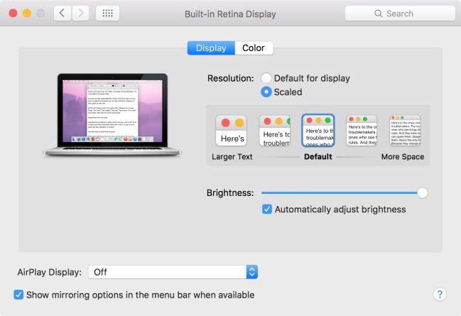

Just to confirm, you'll know you have access to HIDPI when it shows this rather than different resolution sizes?

I've been running an LG UD88 via USB-C. At 4K text is a bit tiny for me, so I have it scaled to 3008x1692. Everything is still very crisp and screen estate is nice as well.
