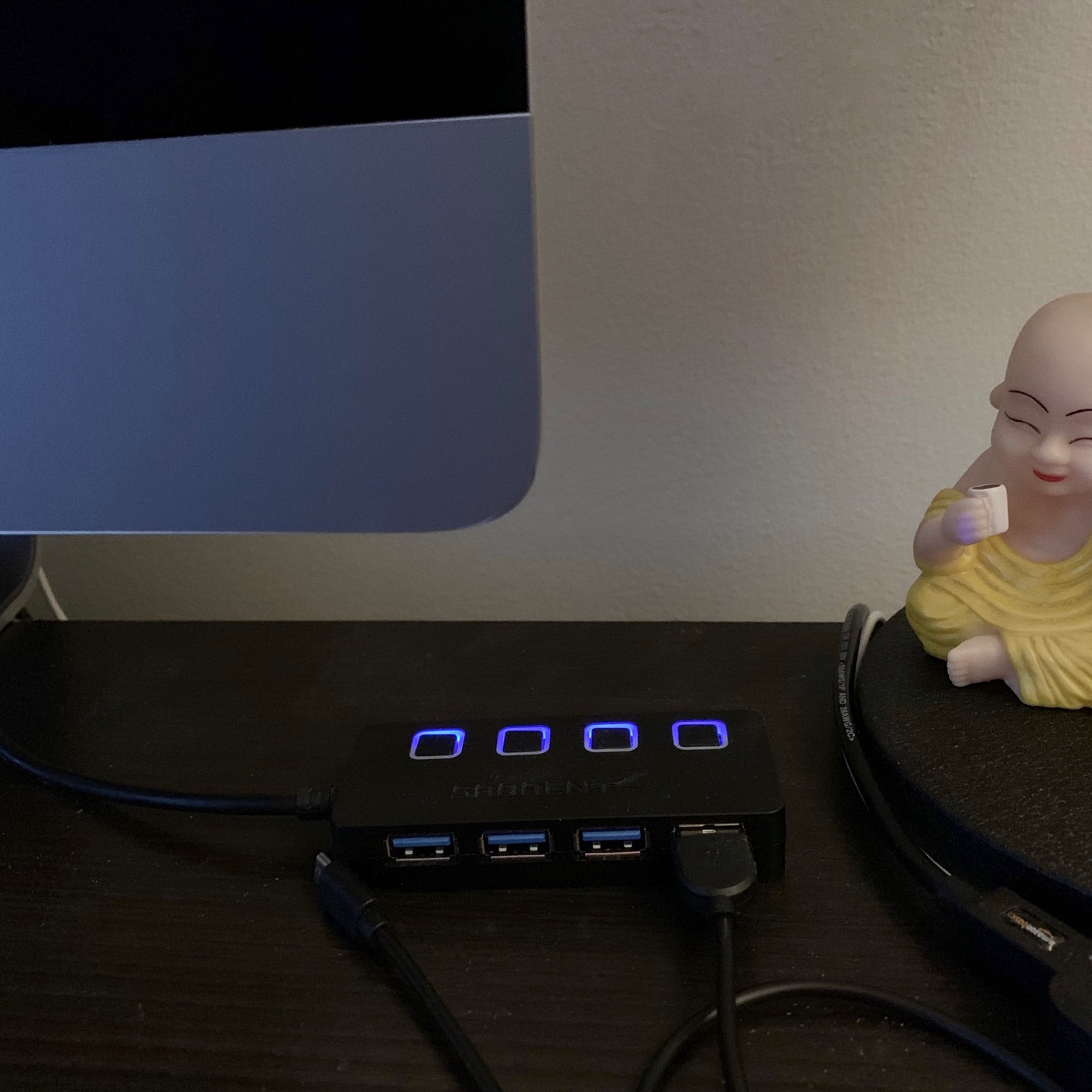

I picked up a Satechi USB-C clamp hub pro. Color matches, sits flush and was very easy to install. More convenient for me than getting behind to access. Will be keeping an eye out for their USB-C stand, as it looks good as well.
Yes, I like mine, too.

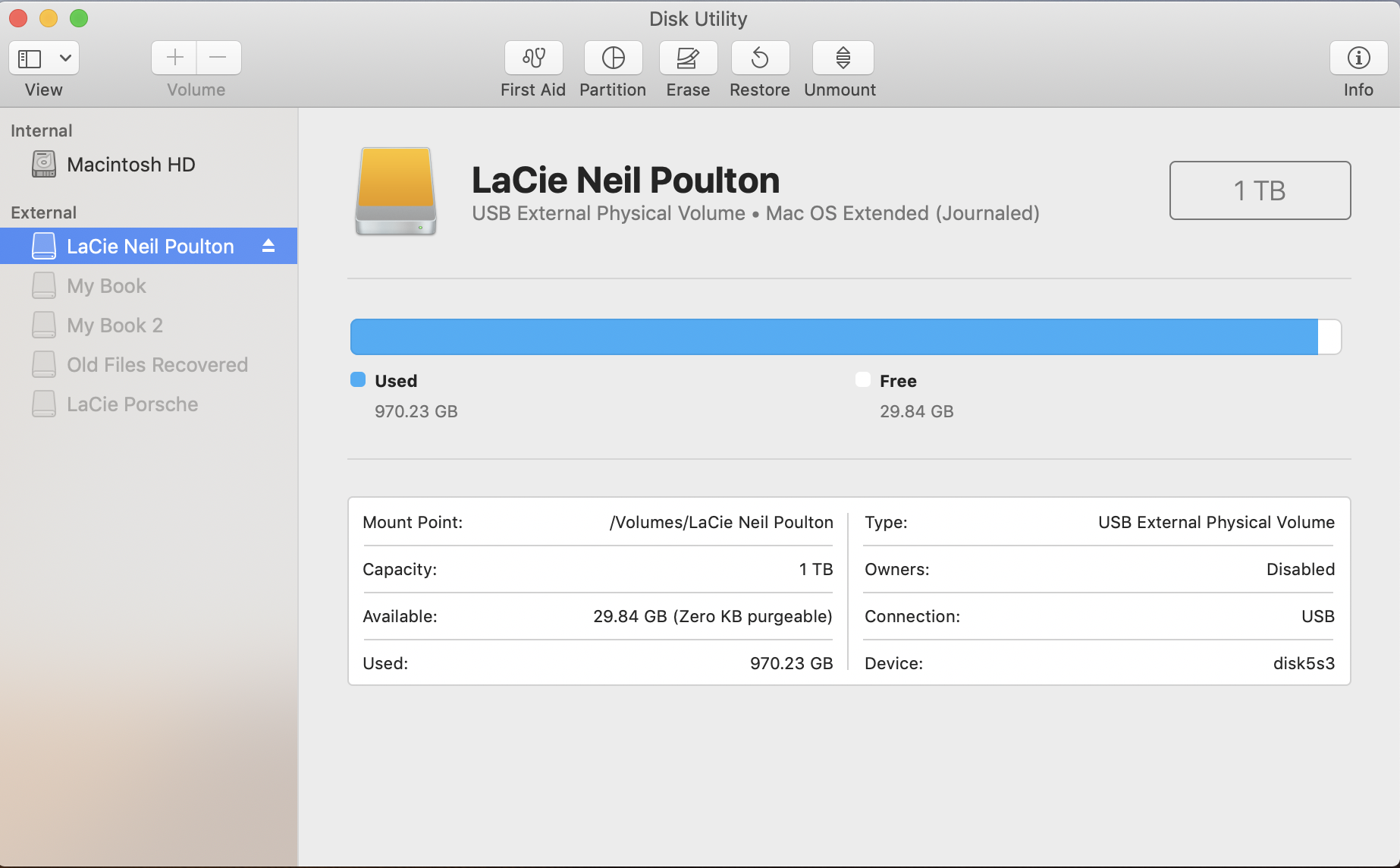

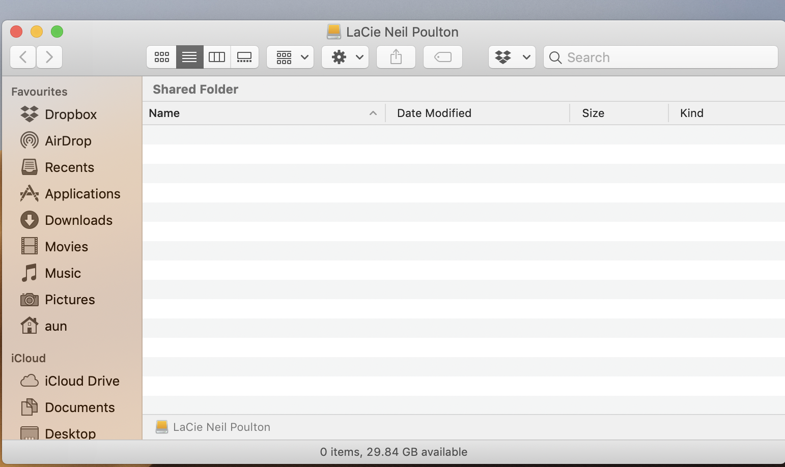

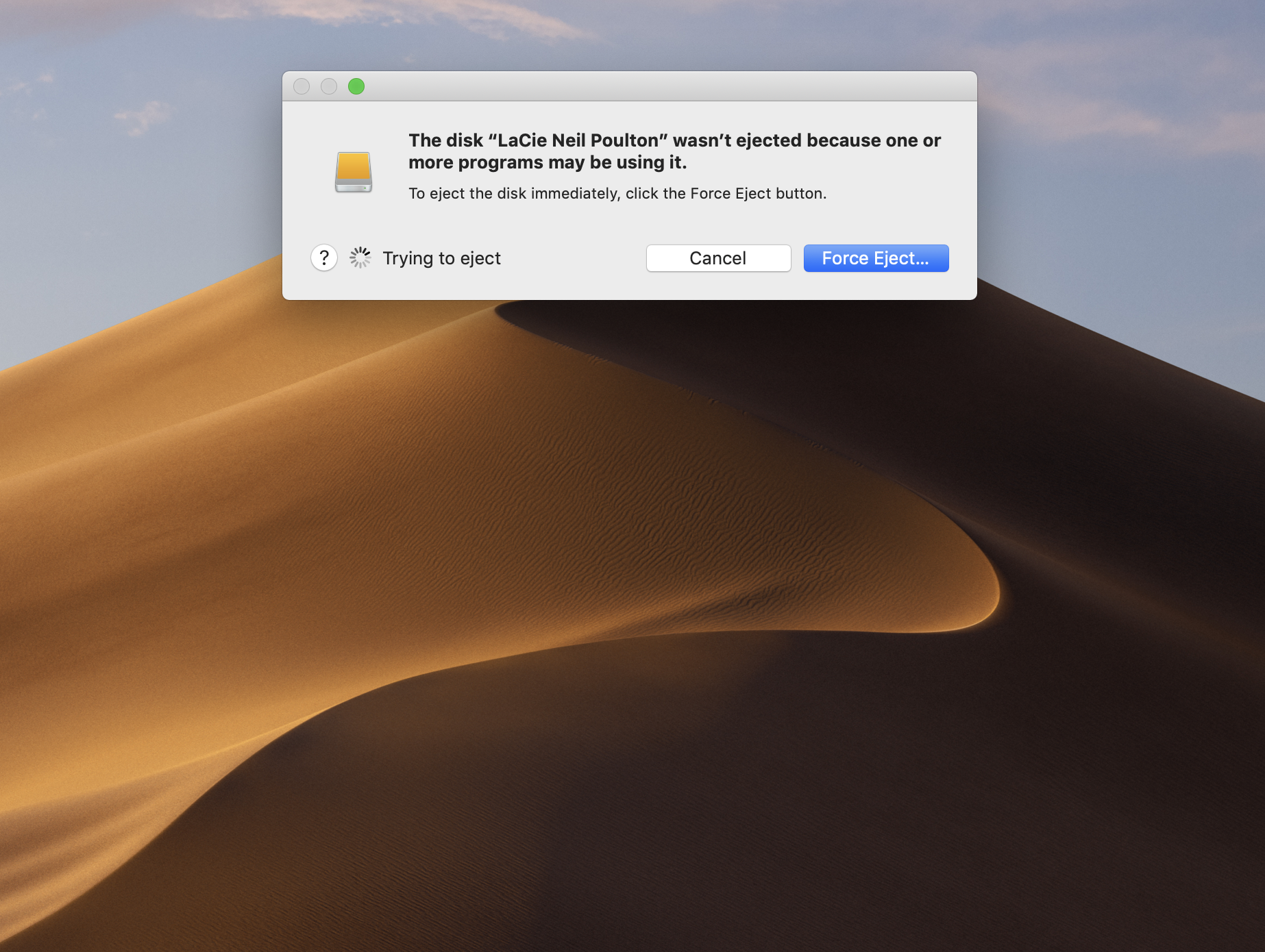

so, even with the drive plugged directly into the imac, it disconnects? reset the SMC (& perhaps, if the problem persists, nvram... you can google instructions)...

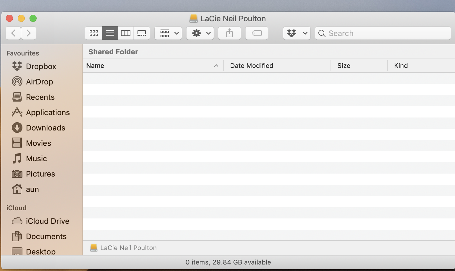

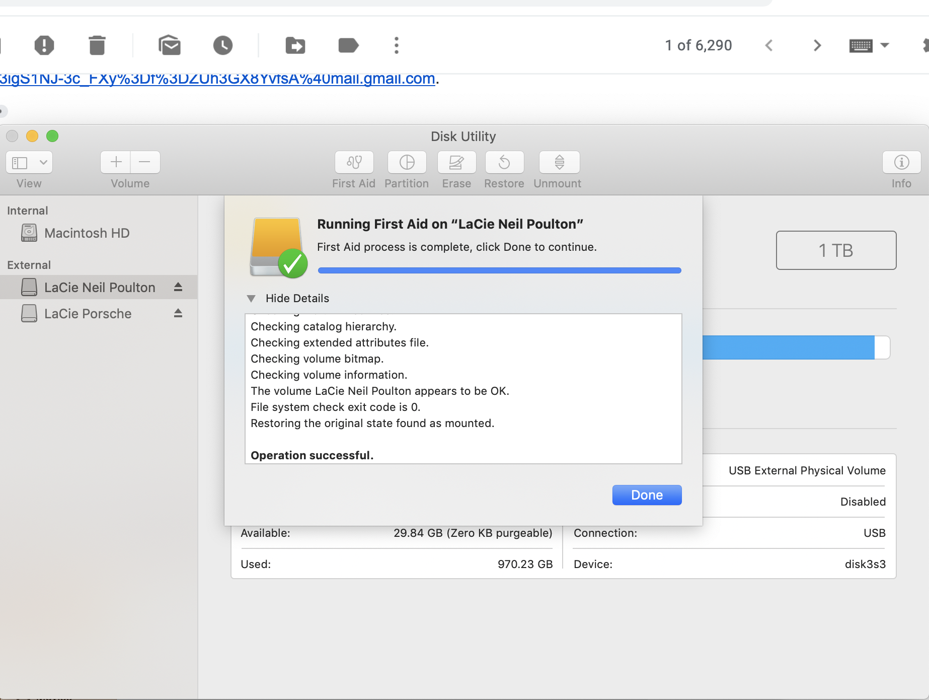

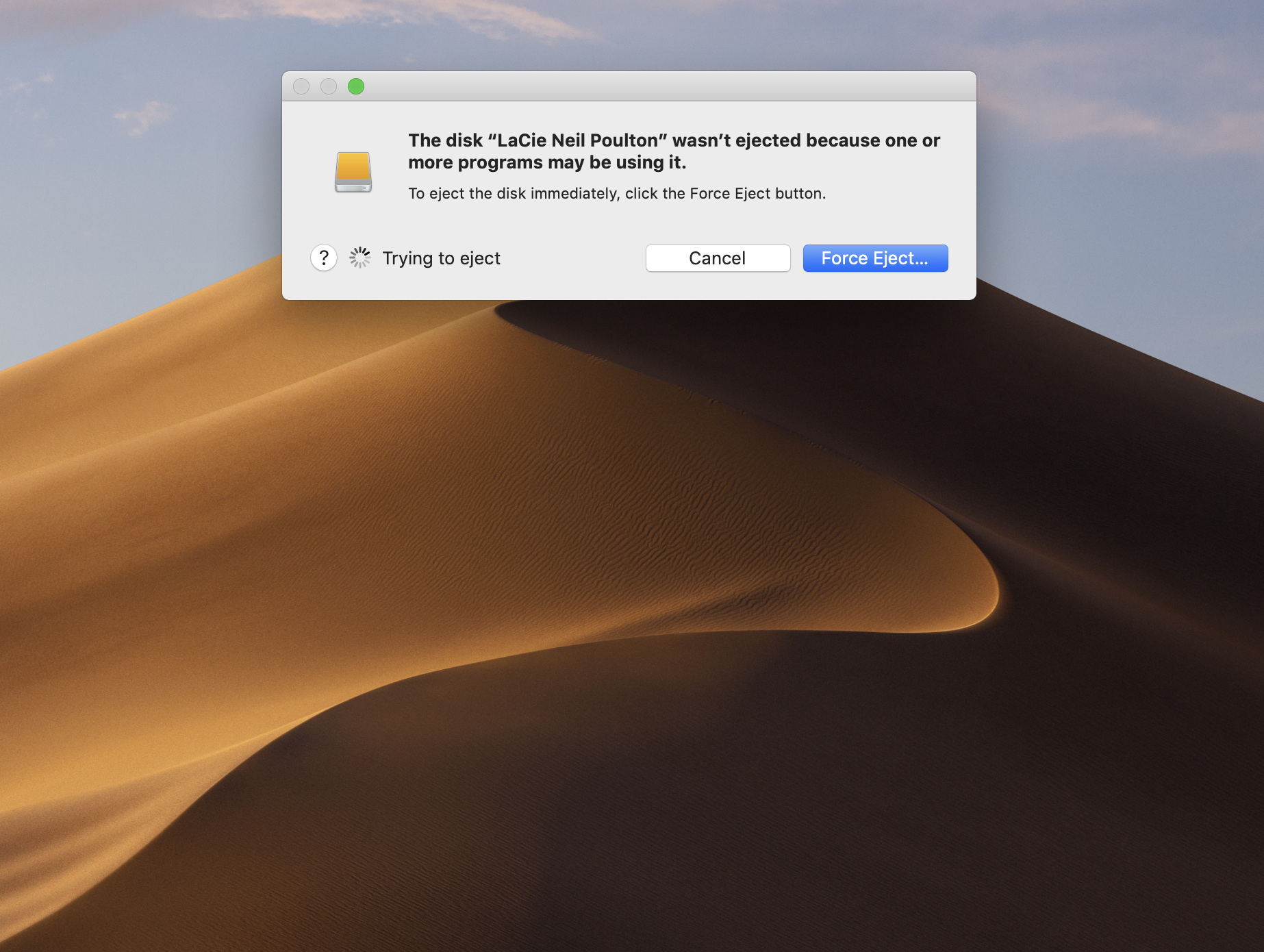

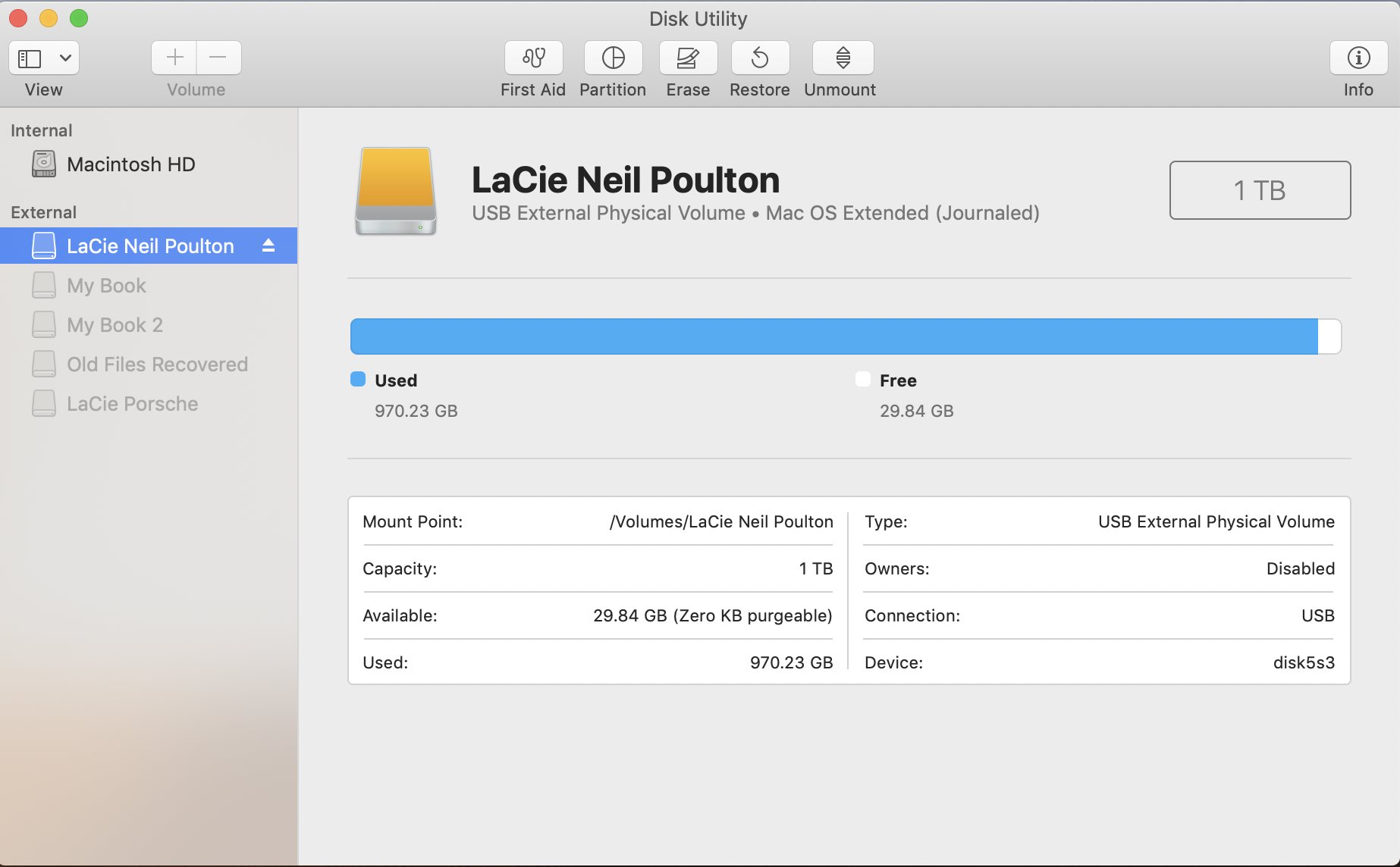

No, it doesn't disconnect. It stays mounted in Disk Utility and I cannot eject it. But when i open the drive it is empty. please see screenshots:

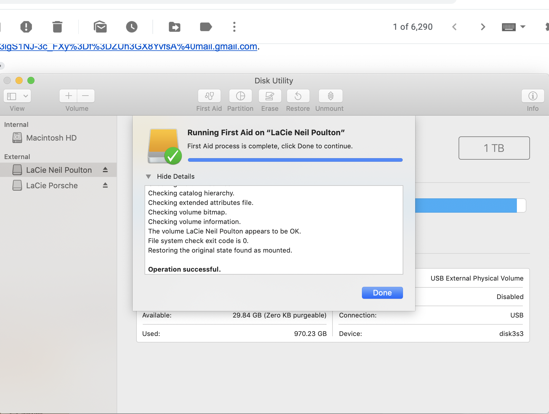

I can only shut down my computer and when i reboot, it is normal and First Aid says all is fine
Before today, it would intermittently disappear from Finder and the desktop, in which case, i could not even open it BUT still stay mounted in Disk Utility just like I described above.
sounds like it's time to replace the drive. get your files copied to a new drive asap (i would, if i were you)...
