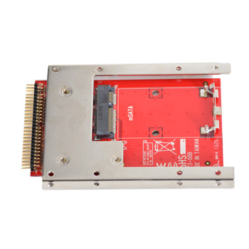

I have a few in mine. Easy to fit. The only thing is that they are silent and on some of my notebooks it takes a while for Open Firmware to do its prechecks before it looks for internal drives. You are never sure apart from the chime that your notebook hasn't frozen.
The one below is my go-to. It has all the fittings to mimic an IDE drive.

You would need an IDE to mSATA. Standard SATA adapters would be too big to fit inside of a portable Mac if that's what you want. I also recommend using those rather than regular adapters in PowerMac G3s and G4s as the clearance for the adapter is extremely small when the case is shut.

are you using one or two of these adapters? I recognized, that when you use two of these green adapters or in conncetion with another IDE-HDD in a PowerMac G4 Sawtooth on the same IDE-ribboncable (Master and Slave) it takes hours to boot and then it will not access without trouble (like transfer rates of 3MB/s and stuttering access). But used alone they seem to be ok. I have one with a red board and Marvell Manhattan chipset, that also has a jumper for Master and Slave.
