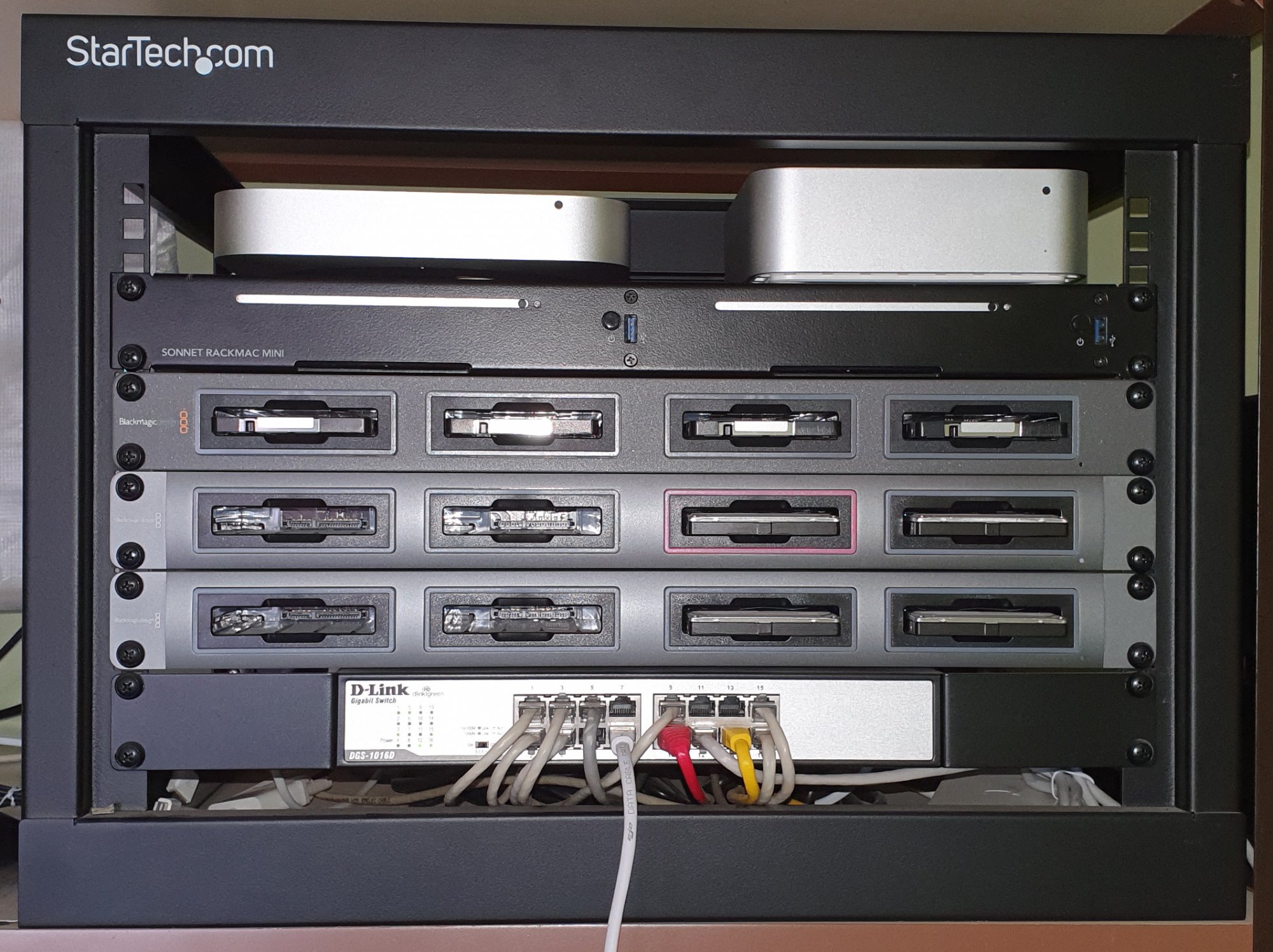

Here would 3 x mid-2100s (2 x 5,3 and 1 x 5,2) and a 2009. The 2 in the Rackmac (the 5,3) are 16GB RAM with 2 x Samsung 2TB 860 EVOs and 2 x Samsung 4TB 860 EVO. The smaller one is my outward facing server handling my mail, calendars, notes, reminders and file sharing etc. The other is more for internal storage and iTunes home sharing. Both are TM backed up to 2 x 2TB 2.5" HDDs in the BlackMagic Multidocks. The spare bays make it easy to do my offline backups and/or more data around a little quicker if I want to say toss in an SSD rather than go over gigabit ethernet.
The 5,2 on the top is currently running Folding@Home and is supposed to be a spare for either of my 2 primary servers. Due to COVID-19 lockdowns though I've retasked it to backup copy and serve data (as an alternate) for a client of mine as their own Mac mini servers are are in theory potentially more vulnerable (no-one can get to it due to the heavy lockdown in Lombardy, Italy). This has 2 x Samsung 500GB 860 EVO in it and the data is on 4 x 2TB Seagate Barracuda 2.5" HDDs that I had laying around in a RAID 10 configuration (FWIW I have everything else in RAID 1 other than the TM backups). This is what I usually do "stupid stuff" on in case I mess up be is really there to be a spare… bought it real cheap 2nd hand and it was used for like 10 mins by the original owner.
The 2009 sits around doing not a lot even though I've maxed the RAM and put 2 x 500GB Samsung 860 EVOs in it. It's my original Mac mini server, and it would bought to be a server, and has done its job. I basically keep it around as a long shot "maybe" given it can happily run OS X Server under El Capitan.
