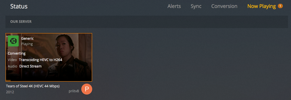

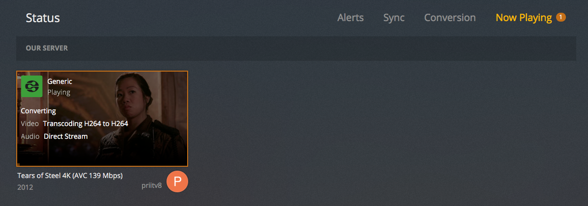

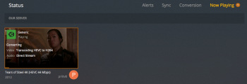

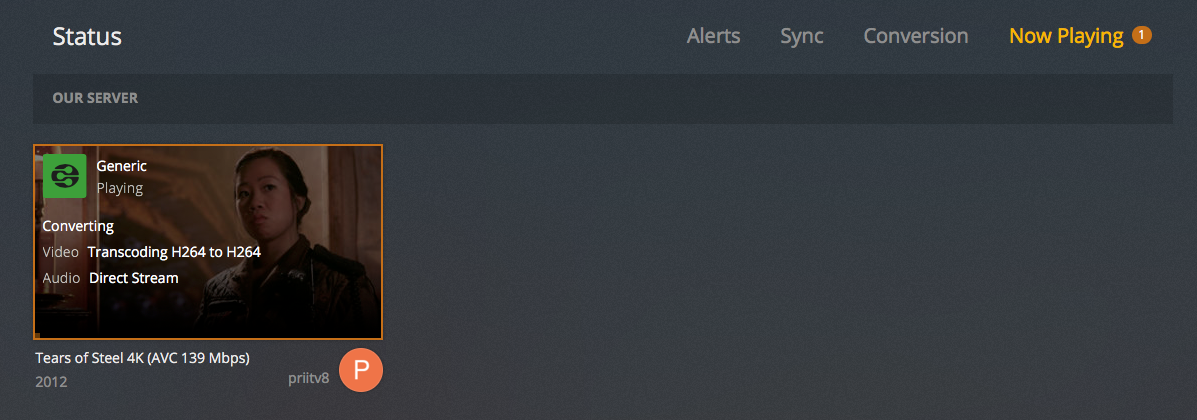

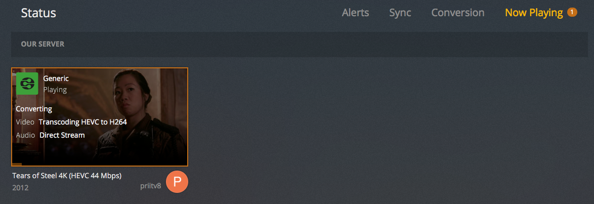

Plex, however, seems to meet it's own decisions. The tvOS client seems to transcode HEVC into AVC no matter what. And my 139Mbps clip is in AVC, but it decides to transcode that into AVC as well. What else but bitrate reduction can it be?
PS That 44Mbps HEVC clip plays back via Home Sharing without any stuttering, over my wired gigabit network. Served by a Late 2012 Mac Mini, 2,3GHz Quad-Core i7, files on Drobo 5C DAS (USB 3.0).
Seems the plex client needs an update for HEVC on the ATV. Though I thought it was updated. The 3 things to look at when it's transcoding are container, video and audio. Since your audio is direct streaming and not direct playing this tells me your container is not compatible.
While your video(AVC) should be compatible there may be something about how it's encoded that isn't natively supported by the ATV. Maybe the profile level?
It's also taking a very high bitrate file(139 Mbps) and transcoding on the fly. This is going to use an enormous amount of CPU. I would not expect a mac mini to handle it. I had a 2015? mini and even transcoding one of my movies which is around 12Mbps it was getting damn hot and the fan was at max.

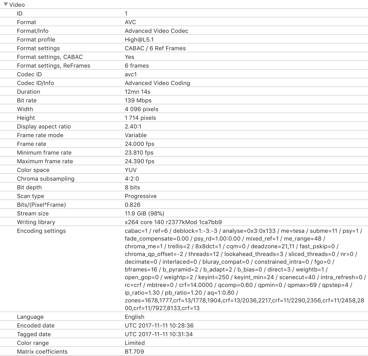

That AVC I have not touched myself. Could be it's 4096x1714 size. Profile is High@L5.1

HEVC encodes I did myself from the above source using HandBrake (x265 library) and HandBrake has been the most solid QuickTime-compatible encoder/muxer so far. Only the FourCC needs to be manually changed afterwards. The proof of that is that the same clip plays back natively in QT on macOS, inside iTunes and on aTV via HomeSharing. Plex tvOS client obviously does not support native HEVC playback. Or has the FourCC issue inverse to QT.
That i7 already has hardware AVC encoder onboard, but Plex taxed it to max anyways and it can not keep up, indeed.
Profile is too high for AVC. Should be no higher than 4.1 though 4.0 is really all that's needed. That could be the issue. What container is it in?
Your HEVC file is fine as you said. Bitrate is much lower and plex has no problem transcoding this one in real time.

True. But as I've said, that is not my encode. Just re-wrapped it into MP4 and called it a day.
Understood. Though for the purposes of testing, if you so wanted, you could reencode that to a lower profile and see if that resolves it.

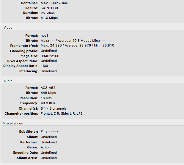

Guys thanks for the replies.... I can say the file I am trying is an m4v that was converted from a mkv by just changing container... Here is the file info:
ultimately you're getting stutter in itunes and not infuse because something about your encode is not fully supported and infuse uses it's own player. Something with the video file I suspect. Would need more detail on the video file.

Missing encoding profile and interlacing info may be problems.
