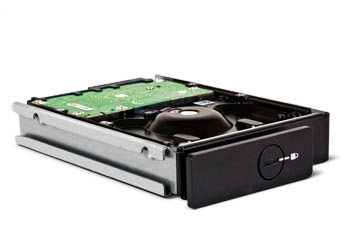

What about if you just put the drive in the bracket and then with the bracket slide it in, without screws? Would that work?
A 3.5" drive can be slid in if you are careful, but without the screws, it will be a bit difficult to extract the drive. You will pull out only the bracket.
If you shoud bump or move the 5big chassis while the drive is unsecured, youmay damage the connector.
You are trying to save a little time. You won't be happy if something goes wrong. You will forget at some point that the drives are not secure, and you will be sorry.
As a shortcut, perhaps you could use only two of the 4 screws. screws. 😀
Here is a pic:
http://www.lacie.com/imgstore/product_overview/4bigSpare.jpg
