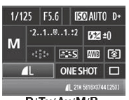

Hi Sunnyj,
since I'm not doing video, I tend to not use LiveView that much , but mostly navigate the menu (see attached) using the joystick. I find the canon menu very easy to navigate.
before I try ML, perhaps you can respond to a few questions since I could quite understand from the wiki.
1) With ML, are you still able to use this menu, or must you use a completely different ML menu (accessed in LiveView via picture styles button)?
2) does the ML menu include all the items on the canon menu for photos ? (Iso, fstop, EV comp, etc etc)
3) to go back to std. menu, do you need to remove/reinsert the batteries?

Hi Sunnyj,
yes you can still use the quick canon menu only if live view is disabled. ML menu is only available in live view mode
no, ML menu only includes items related to ML not iso, comp ect.
either turn the camera off and on or pull the battery out
