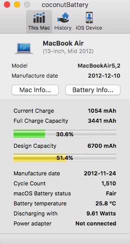

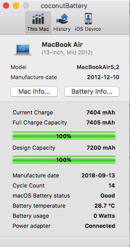

Below are the before and after pics from Coconut Battery.
A couple of interesting things about the capacity:
  1. Notice how the first battery had dropped down to 51.4% of its design capacity.
  2. The design capacity of the new battery is 7200 mAh vs 6700 mAh for the older battery.
BEFORE / AFTER

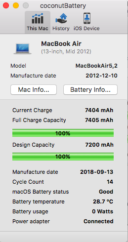

UPDATE after 1 month.
So far, so good. I mostly try to keep it plugged in when possible. But after 14 charge cycles, it's still looking good.

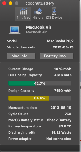

I have a MacBook Air mid 2013 the battery is dying on it. I've had a look around and seen that you can get various 'fake' batteries available. I saw one on AliExpress but then thought against it because by the time it comes over and you pay taxes and duty on it it becomes cost prohibitive.
However, one thing I did notice looking at all these clones, the mAh of the batteries are completely different. Some, but few seem to be the same as the original around the 7150-7200 mark, all the remainder seems to be around 6100 etc. Does that make a huge difference?
I’m not certain that there is a little difference with the new battery versus a five-year-old battery, but I’m not sensing an astounding increase in battery life versus percentage so far.
