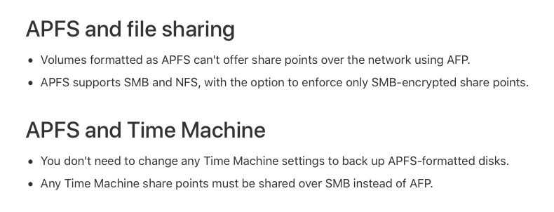

You aren't using AFP by chance? While I was able to get it to work the performance was similar to your description regardless of what Apple says....
Performance with AFP was utter garbage. Automatic updates would corrupt. Max throughput was 7-10MB/s. Prep and verifying were slower too. Apple doesn't recommend 'write caching' for TM for some reason btw.

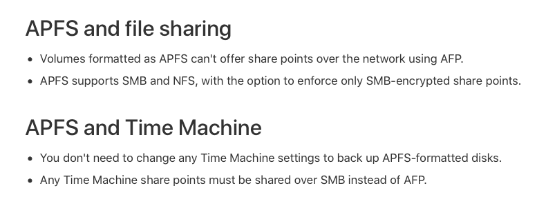

I'm am using a DS216j so there is a high probability your Synology NAS is better than mine. My TM backups are ~2.5TB with my iMac, ~500gb with my MBP. While no where near as large as yours it works very well.
Yeah, I'd swtiched to SMB some time back. I'd also gotten to work with AFP, but I'd read that AFP is deprecated and Apple is moving to SMB. I don't see an option for write caching, so I'm not sure if that's somehow enabled.
