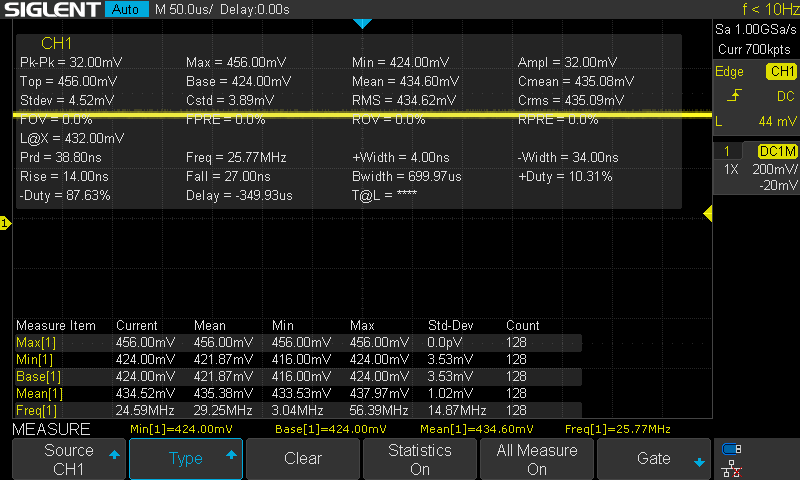

Above at 50% brightness. Everything above looks about the same. No flicker detected.

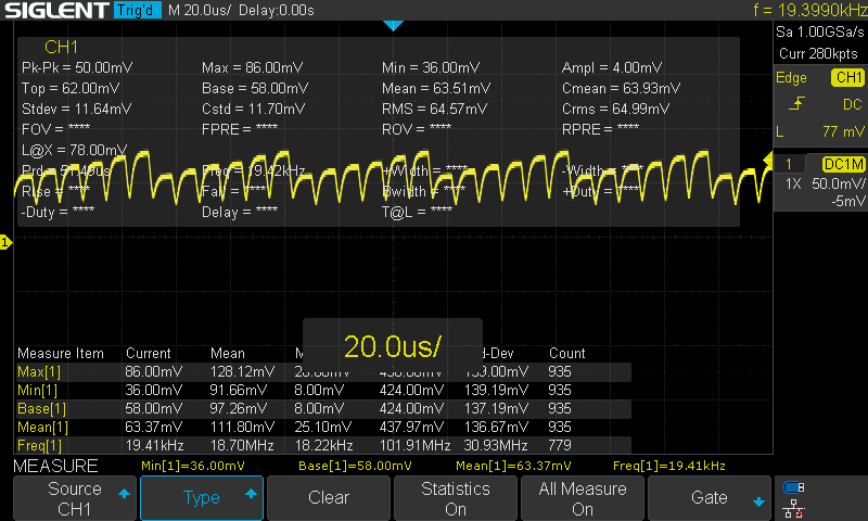

Above at 25% brightness. 19.41 KHz flicker at about 33-50% depending on how you average it.
10% brightness looks similar with similar values.

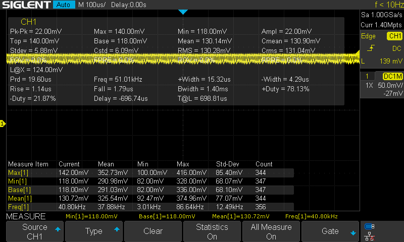

Above at about 48% brightness, or 7 and 3/4 steps on the brightness scale (or 31 out of 64 quarters if you prefer). 40.8 KHz with about 15-16% flicker.
