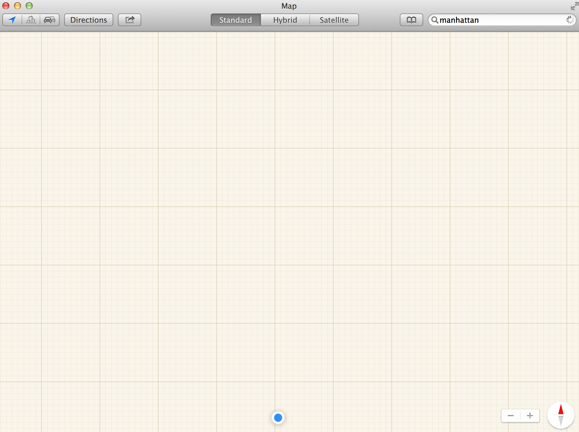

When I open the app it never seems to load any data. It can find my location but you can't see any roads or anything. Wondering if anyone had a method of fixing this?
Interesting, Maps works for me on Mavericks, although it occasionally gets wonky when zooming.
I wonder if it's by location? I live in New York City, if you open Manhattan in Maps are you able to see roads and such?
Oh weird, I just kind of assumed it was broken for everyone on Mavericks. If I try to search for anything it doesn't autofill and I still just get the same blank page.

I did a search for map in Console.app. This is the stuff that looks like it could be to do with the maps app. Maybe I have a funky install of mavericks...
Code:
11/11/2022 08:26:32.440 com.apple.geod[461]: Error downloading resource: Error Domain=GEOErrorDomain Code=-601 "The operation couldn’t be completed. (GEOErrorDomain error -601.)" UserInfo=0x7fbff3e222e0 {NSErrorFailingURLStringKey=https://gspe21-ssl.ls.apple.com/xml/altitude-870.xml?sid=00&tk=b17f203de85ad26556c3bada4b6a03be&mapkey=1668159392_7548958bc4cb5959ea3f0aa37e9b0497, HTTP Status Code=404}
11/11/2022 08:26:05.396 Maps[560]: PBRequester failed with Error Error Domain=NSURLErrorDomain Code=-1004 "Could not connect to the server." UserInfo=0x6000000e9d80 {NSUnderlyingError=0x600000247a10 "Could not connect to the server.", NSErrorFailingURLStringKey=https://gsp10-ssl.apple.com/use, NSErrorFailingURLKey=https://gsp10-ssl.apple.com/use, NSLocalizedDescription=Could not connect to the server.}

10/11/2022 19:18:34.140 com.apple.geod[461]: Error downloading resource: Error Domain=GEOErrorDomain Code=-601 "The operation couldn’t be completed. (GEOErrorDomain error -601.)" UserInfo=0x7fbff3d72540 {NSErrorFailingURLStringKey=https://gspe21-ssl.ls.apple.com/xml/altitude-870.xml?sid=00&tk=b17f203de85ad26556c3bada4b6a03be&mapkey=1668112114_7f3d278ff84797ba66aa917177735a37, HTTP Status Code=404}

Oh yeah I tried uninstalling it to see if that was changing anything with maps but it still wasn't working before. Here's more errors with it installed now:
Code:
14/11/2022 08:18:16.982 com.apple.geod[461]: Error downloading resource: Error Domain=GEOErrorDomain Code=-601 "The operation couldn’t be completed. (GEOErrorDomain error -601.)" UserInfo=0x7fbff3d53140 {NSErrorFailingURLStringKey=https://gspe21-ssl.ls.apple.com/xml/LocalizationStyleAttributes-7.plist?sid=00&tk=6bf6ba3a4b65a6ff39f21f56a2544a9a&mapkey=1668418096_c3dca24973287738644dba65ff7a7ca8, HTTP Status Code=404}
14/11/2022 08:18:27.863 Maps[2734]: *** WARNING: Method userSpaceScaleFactor in class NSWindow is deprecated on 10.7 and later. It should not be used in new applications. Use convertRectToBacking: instead.
14/11/2022 08:18:28.479 com.apple.geod[461]: Will retry tile group change in 10.000000 seconds
It seems that it's that first one that's failing but I really have no idea why
Just tested and maps seems to work fine for me as well. Doesn't seem to be an https issue, it's actually 404'ing from your log. Not really clear why, first suggestion would be to try booting from a vanilla mavericks iso to see if it's an environment specific issue or not.
It seems like this was also a problem back when mavericks was still used https://discussions.apple.com/thread/5467792
But i'll try doing a fresh install on my mavericks laptop from the app store and see what happens. I think the ISO I used originally was from archive.org
I think this was some kind of gradual server rollout, because now the Maps app is broken for me too, in the same way as OP.
It would be great to have some more people report in.

Are you getting same 404 as OP is in log? Can you charles MITM and see if the URL it's trying to access is even valid in the first place?
Do you think there's anyway the Maps app could use a different maps API? like how you've done with your widgets? or do you think that's too complicated? Wondering if this happens on Yosemite or if that uses a different method.
Yes.
...so the reason it has taken me so long to reply was because I kept meaning to set up Charles... but I don't feel particularly motivated to dig into this further. I'm pretty darn sure the app is dead.
Dashboard widgets are easy to edit because we have all the source code—it's all just HTML and Javascript, available in the clear. Maps is a compiled binary, so it's a lot harder to see what's going on. It's not impossible, especially with tools like CharlesProxy (we don't necessarily need to change the app if we can just feed it data which is structured in the way it expects), but it would probably be hard.

i have seen some fixes on cydia for ios 6 maps, and they claim to use a different api. is the os x and ios maps different?
That's interesting: can you paste the description here, as well as the ipa?
Thanks, super cool! Unfortunately, MapsX doesn't appear to be open source. I PM'd the developer on reddit, we'll see what he says. (I don't know if I'd have time to do a port regardless, but I would at least take a look!)
It sounds like it's just doing a really simple URL rewrite. If that's the case—and the developer can tell me what URLs (I'd really like to not spend time hunting them down)—it should be really simple to add this to my proxy.
While I don't think anyone should really care about 2013-era Apple Maps, MapsKit is used by some third party apps (e.g. Day One) and by Calendar, and it would be nice to have that working!
The developer, Maupro12321, very kindly shared the source code: https://github.com/ObscureMosquito/MapsX/blob/main/Tweak.x
Instead of porting this to SIMBL I tried modifying Squid's configuration to do a simple URL rewrite:
$_ =~ s/^(https?:\/\/)gspe(\d*)\.ls\.apple\.com/$1gspe$2-ssl.ls.apple.com/g;
The URL rewrite seemed to be working, but it didn't fix MapKit, which actually appears to have already been using the -ssl domain. You can see the problem right in the system console, the url it tries to access returns 503.
If anyone wants to install CharlesProxy/MitmProxy on a newer and older Mac and look at the URLs being called, maybe we could investigate further. I just don't care that much about 2013-era Apple Maps. There's a reason everyone panned this thing when it came out, sure it got better over time but this is the early one.
