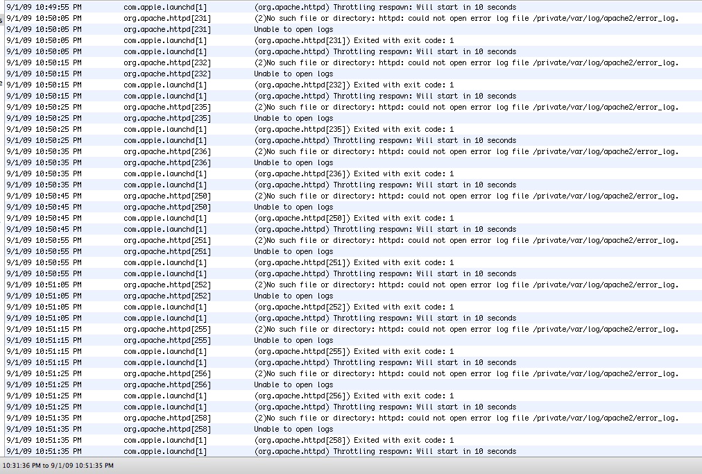

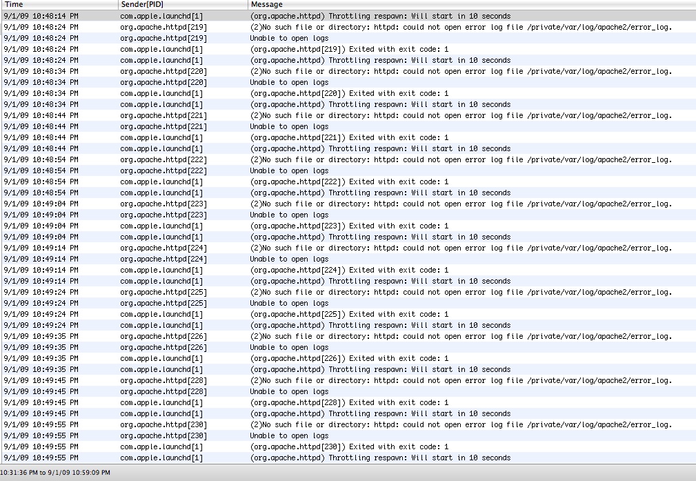

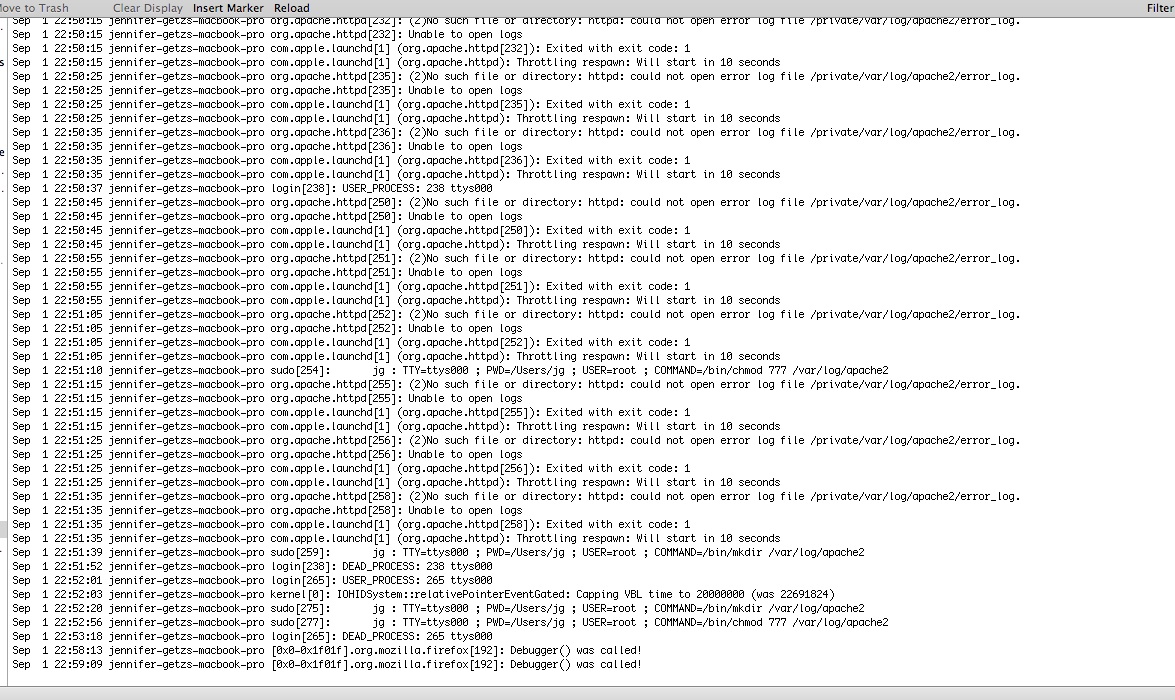

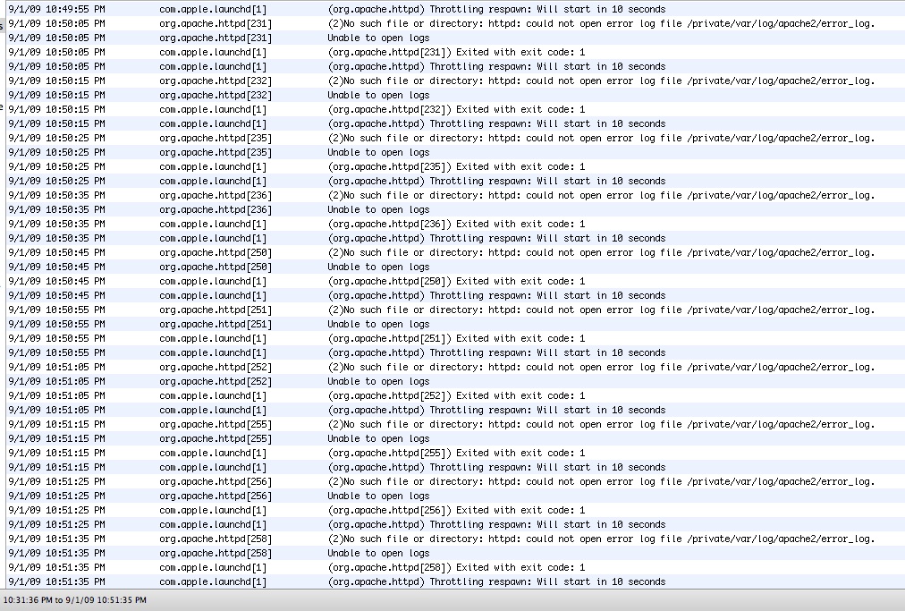

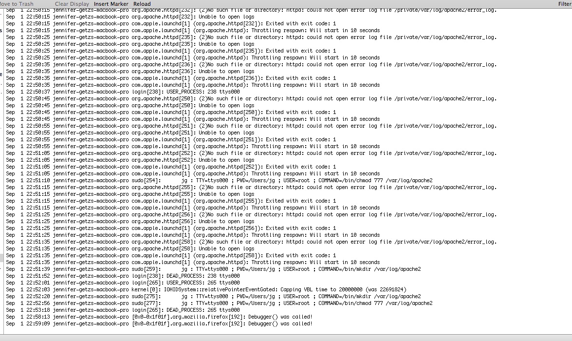

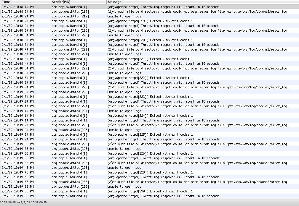

hey, i noticed you guys got some great results here, and was wondering if you could shed some light here??? This afternoon, i had installed a canon printer driver update. Had firefox open, 2 finder windows, and my entourage. i went to search for something in my users/library folder, come to find this folder is empty!! total panic, opened time machine to make sure this folder was full, hopefully from last backup, and all of a sudden, time machine closes itself, takes me to my desktop, and all of my settings are gone...like smoke! Wallpaper became the default Leopard, my icons were enormous, and the dock was default. I did a restart, loaded same way, but weirdly enough, my folders were still on my desktop..itunes and iphoto empty. Wound up doing a restore from backup, but trying to figure out how and why this happened.My console seems to be going nuts with multiple messages, and would love to hear any input.. Took c couple screenshots.
thanks in advance for your input!!
