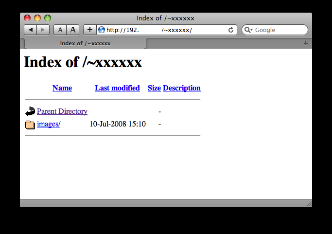

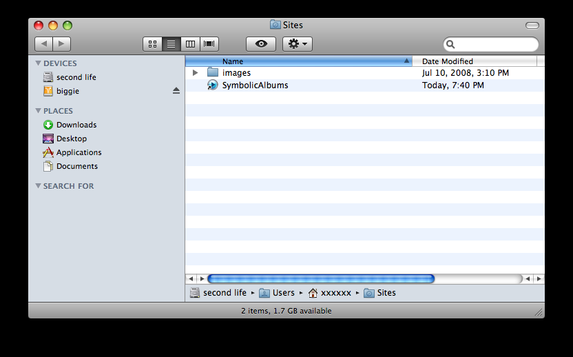

So, I did EXACTLY what that Apple Support document said to do, but it still doesn't work. Here are the screenshots of exactly what I did, and exactly what the results were. WHY DOESN'T THIS WORK?!!?! Someone must know how to make this very simple function work!

If you google for something like "osx symbolic link support apache" you'll get a lot of results with howto's on the subject. One of those can be found below, you might want to take a look at those and compare them with your own configuration.
- http://www.rchu.nl/2009/09/os-x-apache-and-symbolic-links/
- http://abaff.wordpress.com/2008/03/19/problems-with-os-x-leopard-apache-and-symbolic-links/ (take a look at the comments)
Also be sure to check the permissions for the files, folders and symbolic link. A lot of Apache problems are caused by not having the correct permissions.
