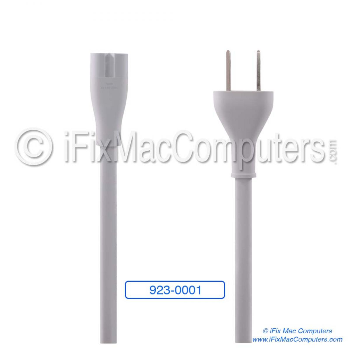

That power adapter doesn't make any sense to me - neither of its ends will connect to the Mini or its power cord. Like I said, a picture of the back of your UPS would be helpful. I think you need something like this:
https://www.sfcable.com/usa-to-uk-b...MI6pKh0ZTQ3gIVhSBpCh1Xcwg_EAQYAyABEgIE1vD_BwE
Unless your Mac comes with a different power cable or an adapter in the box (I don't know how Apple does UK), this is what the Mini's power cable looks like (but black instead of white):

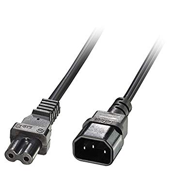

[doublepost=1542071709][/doublepost]If your UPS has BS1363 power receptacles but your Mini came with a US power cord (the one I shared above), then this is probably what you need:
https://www.amazon.co.uk/CDL-Micro-Figure-Mains-Power/dp/B00W1VA3G2/
