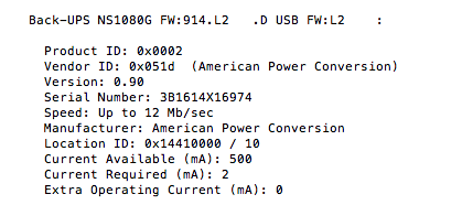

If the data cable is plugged into the UPS and Macs USB but you aren't seeing the UPS tab then open terminal and type
system_profiler SPUSBDataType
You can also goto the Apple icon at the top left > About this Mac > System Report > USB
One of the USB's should report something like this.
If not you need verify the cable is working and the USB port being used is working.
