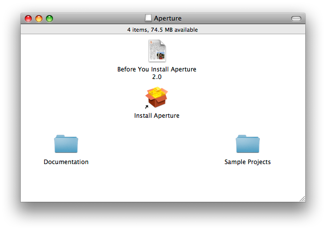

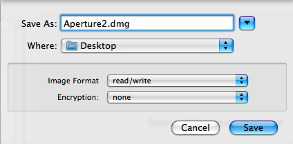

In order to modify the installer package, you can create a modifiable version of the disk image for future so you will only need to create this working installer once for your unsupported G4 machines. Use Disk Utility to convert the read-only Aperture disk image to a read/write .DMG and mount it.
The "Install Aperture" file you see is simply an alias to a hidden installer package.

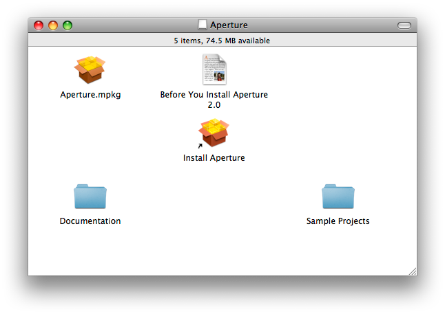

To make things easier, we can unhide the actual .mpkg file within the DMG by opening a new Terminal and entering the below command:
chflags nohidden /Volumes/Aperture/Aperture.mpkg
You will end up with this:
Right click on Aperture.mpkg > Show Package Contents. Navigate to the Contents folder.

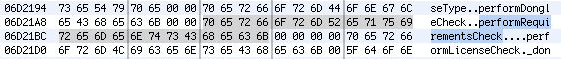

In 0xED, open the file: /Applications/Aperture.app/Contents/MacOS/Aperture.
Change to Overwrite mode in the Edit > Write Mode menu.
Navigate to Offset 0x6D21B0.
You should see the below data:

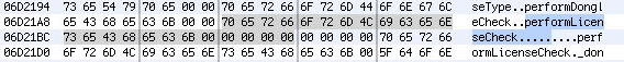

Modify the data so that it exactly matches the below:
Save and close the file. Aperture v2.0 should now work correctly on a G4 system.
