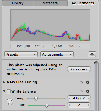

The last time I used Aperture (about a week ago) everything was normal, but today the program suddenly tells me this about all my RAW files: "This photo was adjusted using an earlier version of Apple's RAW processing"
Obviously this should be impossible for the several thousand of pictures that have only existed within Aperture 3 as they would have been automatically processed using the latest version. However, if I filter pictures by which RAW processor was used for decoding, every RAW file except the 6 new files I just imported to check (they correctly show RAW Decoding 3.0) shows that it was decoded with RAW Decoding 2.0.
If I push the reprocess button, my photos change slightly, becoming a little brighter, a little warmer, with a touch more saturation. I exported some JPEGs to compare to pictures I have outside Aperture and there is a definite (but subtle) change after reprocessing compared to my original edits done in Aperture 3. All quickbrush adjustments are available for all RAW files as well, which I thought was only possible if the file was updated to the latest processing...but I'm not sure about that.
I restored my library from a vault (updated about 1 week ago, unsure if before/after this issue began) and I get the same message. The only change I've made recently has been installing the Camera RAW update that came about in the past few weeks. Is it possible that made this suddenly start happening?
Of course I want to have the latest RAW decoding for my files, but I'm concerned that pictures I edited and exported months ago appear to have a different version of RAW processing than Aperture now wants to give my files. Anyone with a clue of what's going on or what I can do to troubleshoot this issue.

I've got the same version of Aperture and OS X as you and a Nikon D40. I too get the button at the top of the adjustments tab stating that the photo was imported with an earlier version of Apple RAW and needs to be reprocessed. FWIW, I've only ever had Aperture 3, never any of the earlier versions.
It must be the update, which I installed earlier today.
Thanks. I guess there was a change in default D40 RAW processing with the latest Camera RAW update. Since Aperture can only list the processing by version 1.0, 2.0, or 3.0, that's why it shows at 2.0 when it. It would be more accurate to say the RAW was processed with 3.0 and the reprocessing would be 3.1.

You're missing that this is the expected behavior: if you're reprocessing your file, the result will look different from before. Professionals do not want that Aperture reprocesses files automatically since then the result will look different from before. All the edits that may have been done to an image may become meaningless and countless hours lost.
If you want to take advantage of Aperture, you need to reprocess the images. Then you indicate to Aperture that you don't mind the changed appearance.
This statement isn't exactly true in this case. When upgrading from an older version of Aperture (1.x, 2.x), the processing that goes on in Aperture is necessary to take advantage of all the features of the program.
Apparently the 3.3 RAW update changed how Apple handles processing for many older cameras...no editing options become unavailable in Aperture if reprocessing is not done. For pictures that are edited to satisfaction, reprocessing is pointless and a waste of time. For new imported RAW images, it just provides a different starting point for editing.
Some cameras seem to have severe color issues (turing green, etc.) while others, like the Nikon D40 (at least in my case) actually makes a slightly nicer looking conversion. But it would have been nice not to have this happen unexpectedly and unannounced. Then I wouldn't have wasted several hours trying to figure out if it's a bug before spending another hour or two experimenting with the changes to adapt it to my workflow.
