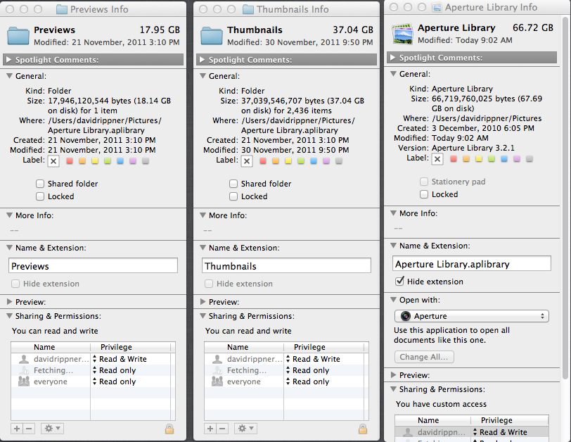

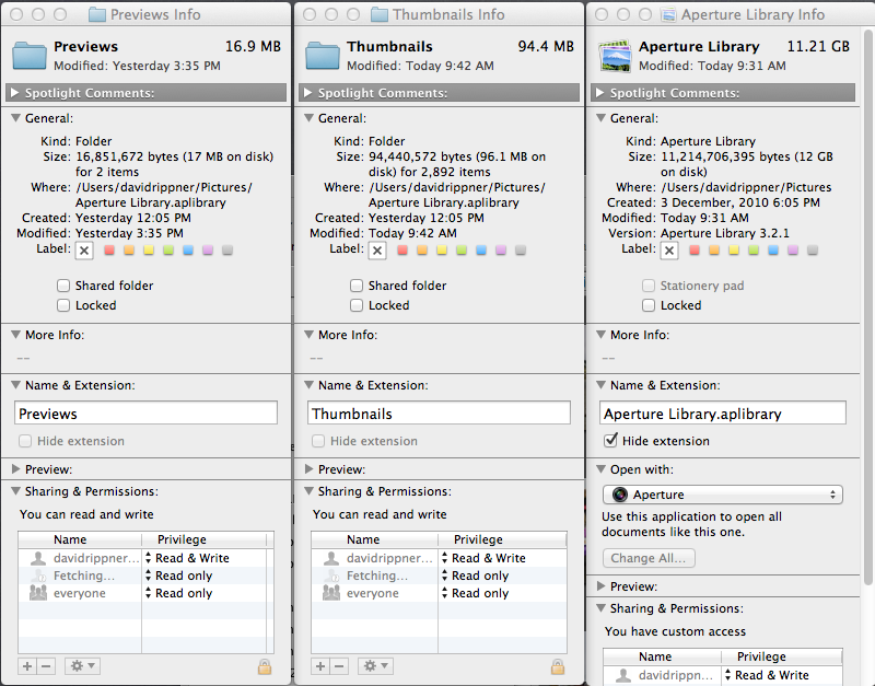

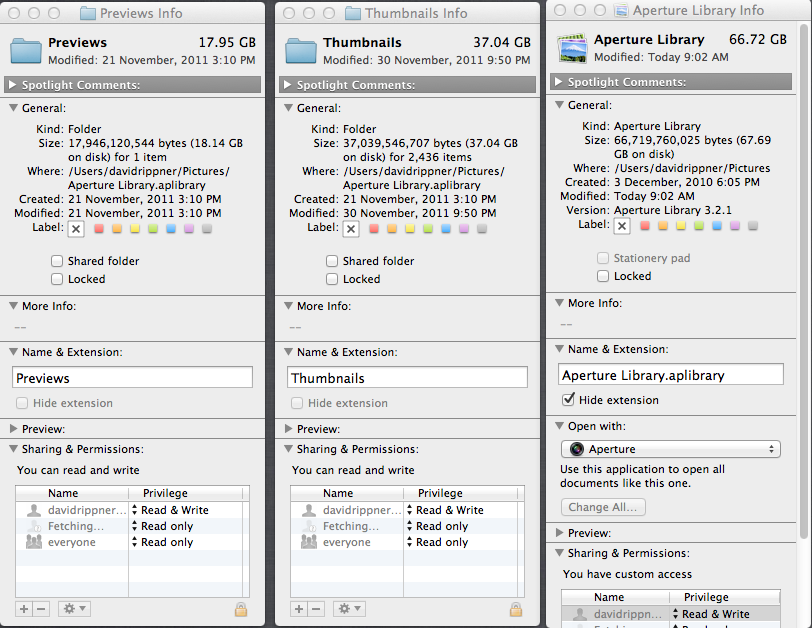

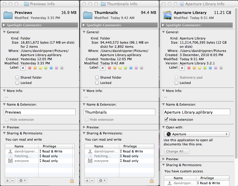

Here are my before and after stats. Now I'm waiting for the trash to flush, something I've done again and again over the past few weeks. It helps to be compulsive if one uses Aperture. And very patient.
I also maintain an iPhoto library; that one presently is over 140GB. Can I perform the same surgery on it and expect similar reductions? Once my trash is empty (and it could take days, at the present rate) I'll work on that one. If you have experience with doing so, I'd like to hear about it.
