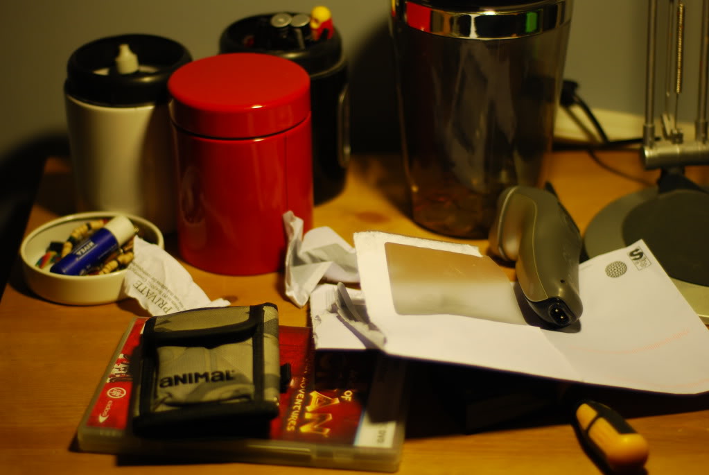

I have just took two sample pictures showing the differences. They are only slight.
I used a Nikon D80, with the Nikkor 50mm prime lens, ISO 100, 1/60th Shutter speed. I couldn't select F2.4, so had to choose F2.5 and F2.8 instead, so it's not quite as big as the difference between F2.4 and F2.8, but you get the idea. You should be able to tell the F2.5 is slightly brighter. And no, the IP4S will definitely not take pictures that look this clean in low light, not even close 😉
Shot at F2.8
Shot at F2.5
2.0 is where the magic starts to happen though.
Yeah. F1.8 shot incoming just for comparisons sake..
Here we go. This clearly shows the advantages of using low fstop.. this is F1.8, way bigger aperture than Ip4s can achieve. Look how much brighter it is.
