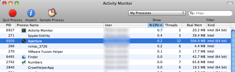

flosseR, in Activity monitor, how much RAM (real and virtual) does it show Aperture using at rest?
I ask this because there appears to be a severe memory leak. When mine starts up, it's using about 800MB of each and steadily climbs to about 1.5GB. That's a lot for an app that's just sitting there.
It has been idling all night to check what you were saying:
