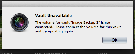

I am using 2 X 3TB WD USB3 external HDD for my vaults
Had a large shoot yesterday, uploaded all the images OK,
Did a little editing,
Hooked up both drives,
Went to "update vaults"
One drive was showing disconnected, clicked on that drive and got this message
Then ejected the drive, reconnected, still no change?
Disconnected both drives by ejecting,
Disconnected all cables,
Closed down the iMac, made a coffee 🙂 and restarted the iMac
Reconnected the Drives, same drive still "not connected"?
Any ideas?
FWIW, when I access the drive through the finder, I can access all the files in there, so, one would think it is connected but not connected when in Aperture mode
Personally, I've stopped using vaults. Instead, I just use CCC to make clones to my entire Aperture library.
I cannot think of any advantage of using the vault feature over just cloning the entire library. CCC makes incremental updates to the destination, so it generally completes in a few minutes (if even that long).
I have my machine set to make a clone to an attached Thunderbolt Drive nightly... and I also have a pair of cheap USB drives that I rotate off site to my work office.
This is all on top of my machine being double backed up locally and to the cloud using Time Machine/Time Capsule, and Crashplan.

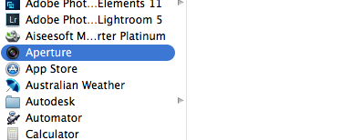

If I get CCC, is this where the library is?
Hi Jim
To be honest, I done really have a handle on how vaults really work
I keep most of my work referenced due to space, basically, have the current year managed and the rest managed (I think you meant to say "referenced)
The vaults are on 2 external drives
Workflow is that I backup to one of these drives on import
I was thinking that as I backup out of time machine to 2 external drives, I would still be backing up the referenced files?
lastly,

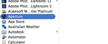

No... that looks like your aperture application. Your aperture library should be located in your pictures directory by default.
I am still a bit confused on where you keep your referenced originals. I would recommend that you NOT keep them on the same external drive that you use for backups. The reason is that then your originals, and your backups, would be on the same physical drive... and hence if that drive failed, then you lose both your originals and your backups at the same time.
Instead, if you are going to have an external drive for your originals... then I would have them on a "primary" external drive... and that when you back up your aperture library (to your two external backup drives)... also make sure that your originals are getting backed up at the same time.
/Jim
