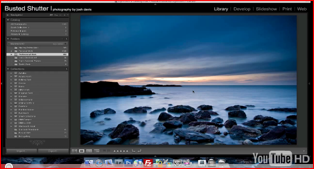

The folder system look easier to read. In LR everything is in blocks which can take up quite a bit of space and you have to look for things more.

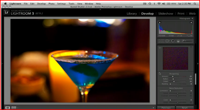

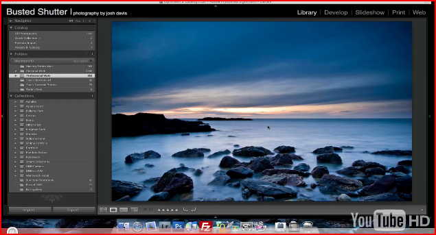

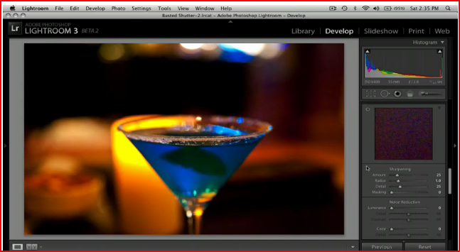

Heres a screenshot of LR 3 with the non-required panels minimized. I think that if you minimize panels, you can get a very good work space similar to Aperture 3.The second screenshot shows what the library module looks like with the ' quick develop' panel closed (on the right, which is mainly used for keywords)
Note: Image if from a youtube video, not my own.

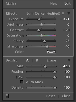

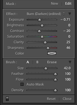

I beg to differ with the "raw editing power" where LR wins. I have both applications and there is give and take on both ends.. but the painting on curves etc. in Aperture is unsurpassed...
I have not found this feature in LR, but please if someone could point me into that direction? I don't mean gradient applying like in LR2, but actual brushing with adjustable brushes and edge detection etc.
If you don't know what I mean, I wrote about it here with samples:
http://go-dslr.com/tutorials/postprocessingtutorials/aperture-3-awesomeness-brushing-curves-upon-curves-look-mom-no-photoshop
This is the one feature keeping me on A3 (aside the organizing) because it works absolutely awesome...And being able to brush these curves or other adjustments on top of each other is just mind boggling..

Here you go: http://help.adobe.com/en_US/Lightroom/3.0/Using/WS76ADBBEE-5B0D-458f-AB8A-DC49C0338292.html
Check out the Targeted Adjustment tool.
