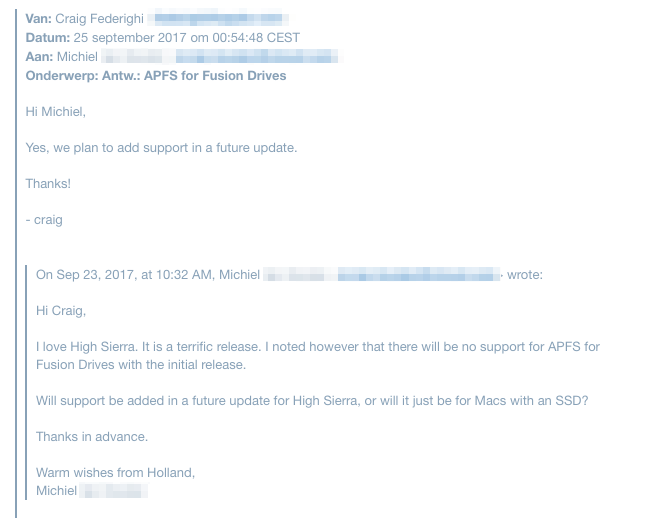

Wrote to Craig Federighi and recieved this reply:

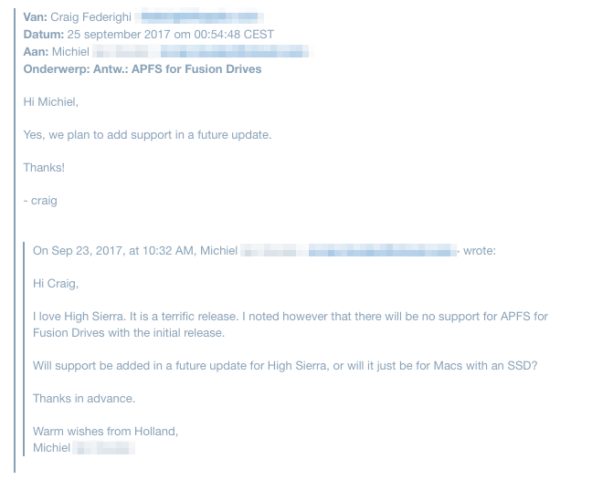

High Sierra doesn’t currently convert fusion drives to APFS. That was a feature in betas but it was removed in the final release. Support for fusion drives being converted to APFS will be coming in a later High Sierra release.
So if you’ve never converted your fusion drive to APFS (by running a High Sierra beta) you’ll be fine upgrading now - your fusion drive will stay exactly as it is file format wise.
