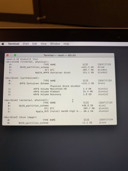

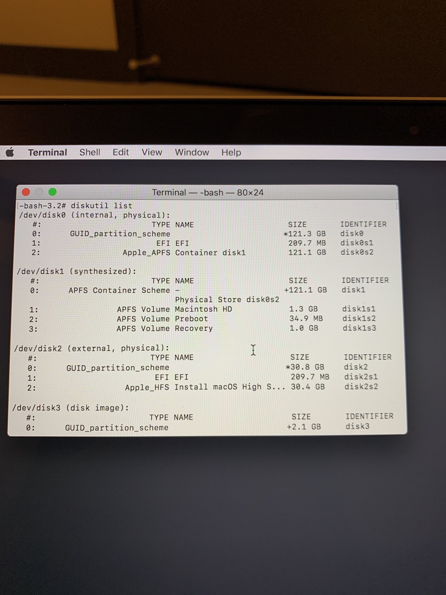

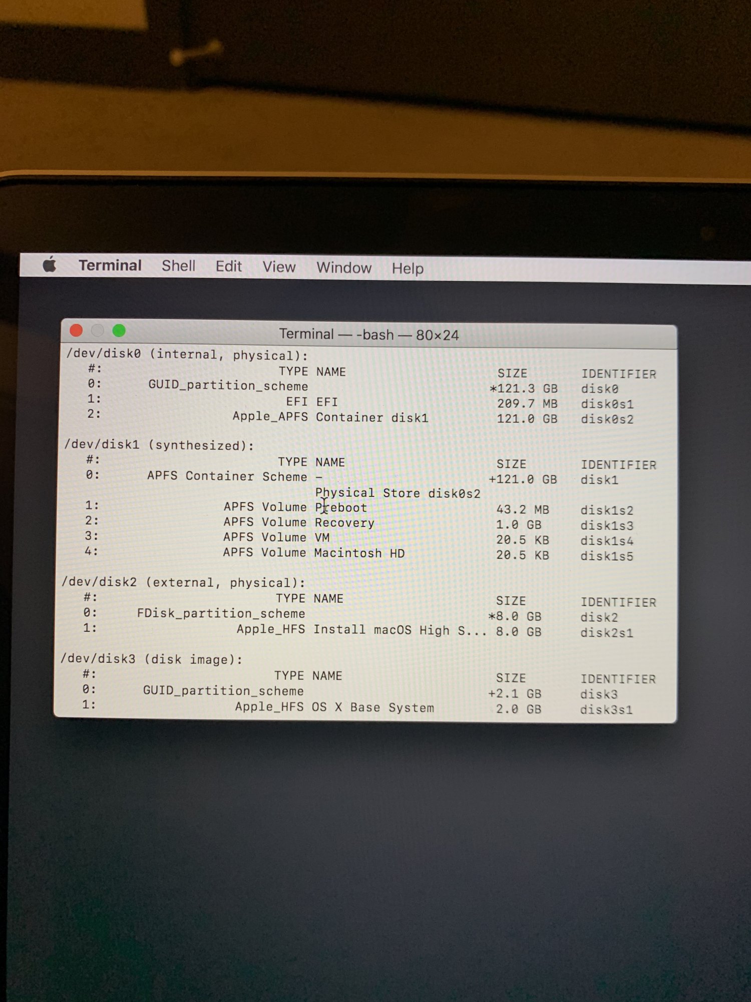

I formatted my SSD and it looks like Macintosh HD was assigned to disk1s5 instead of disk1s1. Is this normal? If not, how can I fix it?

Is the system (or the SSD) giving you any kind of problem?
Yours looks pretty routine for an APFS format drive.

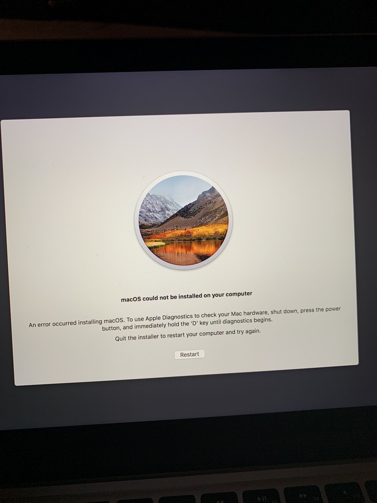

Yes, I am unable to reinstall macOS currently, and puts me in a loop telling me to restart my computer to try installing again.

You're trying to install macOS High Sierra, from an external drive, is that correct?
How did you prepare that external drive to be bootable? Looks like it was not made on a Mac (?) (Fdisk?)
Reactions: chabig

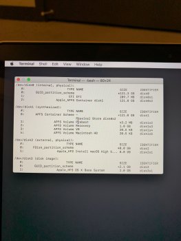

Update: I redid the bootable external USB, and formatted the SSD again. Now it looks a little different, but still gives me the same error.
Reactions: tinygoblin
What is that 2GB disk image? I think you just have two drives connected, an internal SSD and an external USB drive.
You are correct, I just have the internal SSD and bootable USB with High Sierra on it. I’m not sure where that came from. How do I get rid of it?
