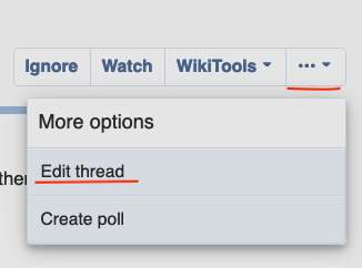

In your original post, upper right area, click on the dropdown menu and select "Edit thread".

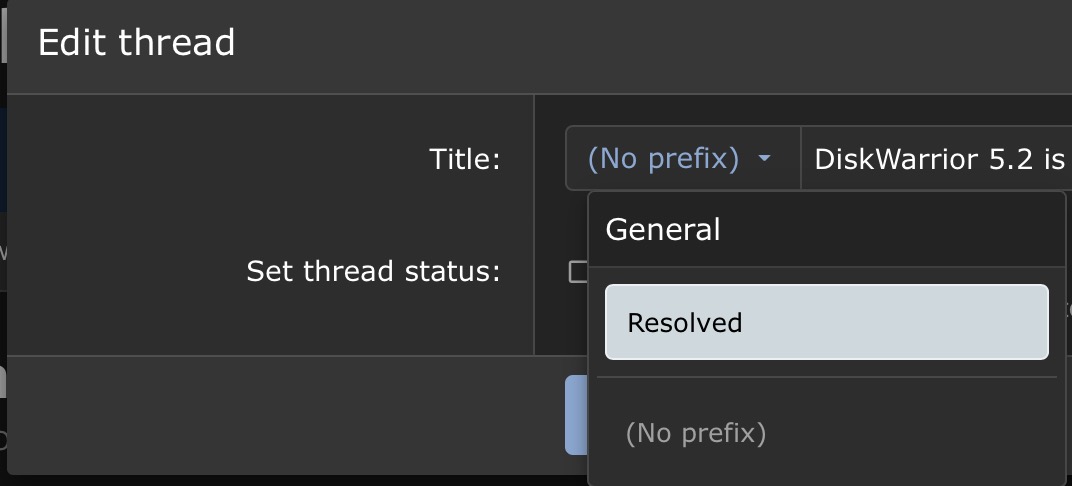

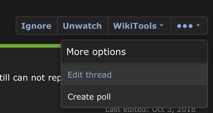

On a thread that you started;
Click on the 3 horizontal dots on the right side above your 1st post:
Select "Edit thread" > "(No prefix)" pull down > select "Resolved"
