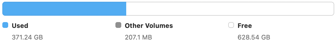

I formatted a Samsung T7 1TB portable drive as APFS with a name "NAME". It appears with that name on the desktop and in Finder window sidebars, BUT some (all?) apps see it as "NAME 1". Looking at the drive in Disk Utility, I see the drive is one volume, with mount point Volumes/NAME 1/ and the following structure:
What is going on? Should I just ignore the " 1" added to NAME in some apps? If I add another volume to the disk, would it be NAME 2, etc?
