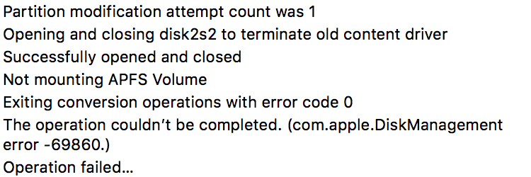

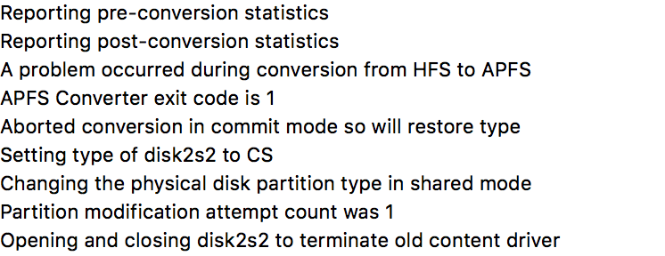

I've tried converting two drives. One, a HDD over usb 3, worked completely without issue, and performs as expected. The other, an encrypted HFJ+ over usb 2, failed repeatedly, but the disk was not damaged and did not need to be repaired.
Reactions: grahamperrin
Can you recall the details?
If you use diskutil instead of Disk Utility, you'll probably get more information.

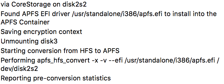

I'm not that concerned, I'm about to replace this drive anyways, but here's the detailed conversion log. Screen Shot 2017-07-02 at 4.46.54 PM.pngScreen Shot 2017-07-02 at 4.46.28 PM.pngScreen Shot 2017-07-02 at 4.49.17 PM.png

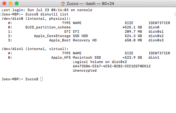

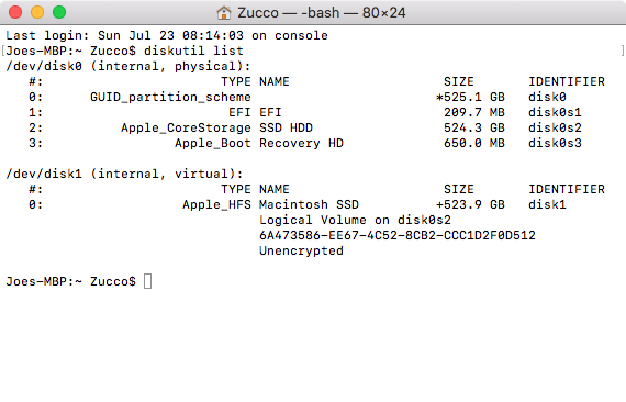

Do you see anything odd here that would prevent me from converting? I get error 60953. I am not sure why I have a virtual and a physical. I originally named the drive SSD HDD when I formatted/partitioned it and renamed it in the OS to Macintosh SDD. Thoughts?

I don't see anything weird, could be because you're booted into it. Maybe try from the recovery partition. The virtual/physical is mostly likely because you have FileVault on or the disk is an encrypted journaled system. All encrypted volumes/partitions have a "CoreStorage" partition that is virtualized when unencrypted by the system.

Thank you for your insight. I appreciate it. I have tried to convert in recovery mode and unmounted the drive. I don’t use fire vault and I don’t have it encrypted. But you have me thinking that maybe the core storage virtual partition is getting in the way and not correct?

So when you run diskutil list from terminal it looks different than this?

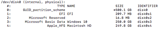

This is all that I have on this laptop, but it's also a hackintosh. Though the same is also true for external unecrypted/encrypted drives on my real Mac at home.

So the virtual drive looks odd to you? It’s funny because Macintosh SDD is my boot drive and I named it that AFTER I named it SSD HDD. Seems weird SSD HDD is even showing up.
Seems weird if you've never encrypted or used filevault, but I don't know if there are uses for CoreStorage volumes outside of that. Ex: pretty sure all APFS volumes show up as CoreStorage + virtual but I'll have to check my unencrptyed disks later.
Edit: Perhaps it's part of a failed APFS conversion?
Exactly. That’s what I am thinking.

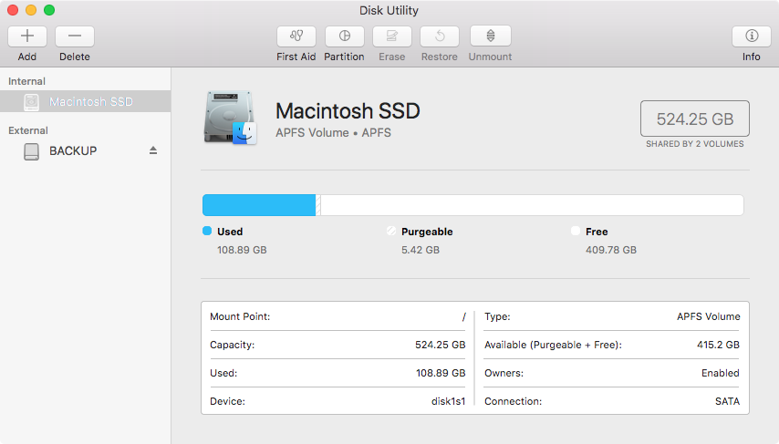

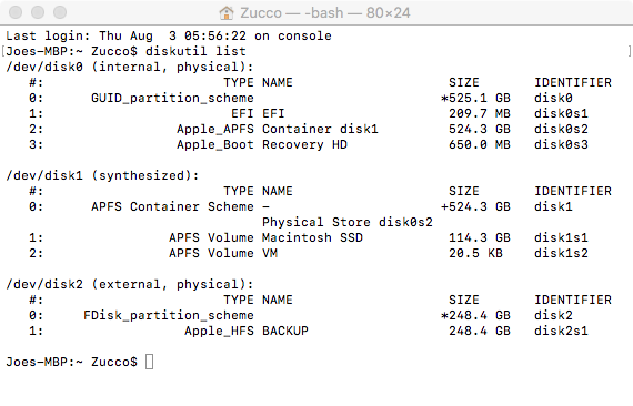

Well I finally have achieved success and it was less cumbersome and risky than I thought. I imaged my PB3 install over to a 256GB USB stick using CCC. That went fine. I booted from the stick and was prepared to wipe the internal SSD clean. For the hell of it, I first went into Disk Utility and thought I would give it one more shot at converting. It did this through the normal boot from the stick and not from recovery mode. I unmounted the internal SSD, selected Edit/convert to APFS (anticipated fail/error), it converted successfully in about 30 seconds. Crazy.
I am not sure what my issue was, but I suspect booting from the USB really unmounted my internal drive completely including the physical and virtual volumes (whatever the virtual is?). One of those had to still be in use when I have been getting fails.
Thanks for all your help. You were right about the virtual volume and the clutter from a failed HS install. That happened when first trying to install PB1 and checking the box.
How does everything look? Before converting, I would have Crucial Storage XXXX and Macintosh SSD looked like a slave or sub to it. Now it looks clean. I suspect the "Shared by Two Volumes" is normal and one it the recovery partition? The last record on my diskutil screen shot is my thumb drive.
I just got a chance to look at mine, and the only real difference is that the recovery partition is in the synthesized volume and I have a reboot partition. The "two shared" is because apfs disks share all available disk space. If you had an external apfs with two partitions, they would both share the entire space of the apfs and consume the space as the partitions need. That's why the Macintosh SSD shows up as 115.3 GB partition, because that's the space it's used of all apfs space. At least this is my understanding of how APFS is supposed to work. Mine is shared by 4, because I have a preboot, and recovery apfs. Apparently the VM is essentially a swap space partition.
Thanks, got it. Makes sense. I am happy I got this sorted out with your help. I just knew the error wasn't beta related.

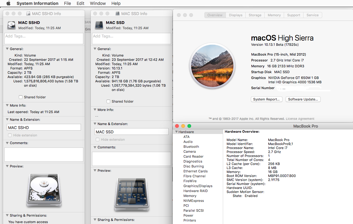

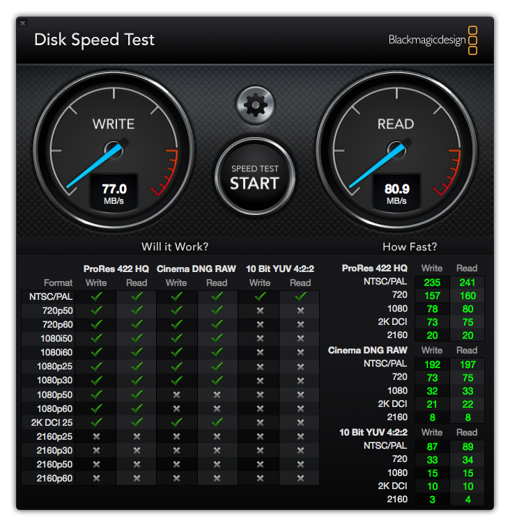

yup can..i converted my 2TB Seagate Firecuda 2.5" from HFS+ to APFS in my MacBook Pro 15inch 2012 non-Retina 2.7Ghz i7 Quad-Core A1286 last week and the read/write performance went smooth and faster (checked it via Blackberry Disk Speed Test app).Anyway this is drive is just my secondary drive where i just put non-system files like documents,videos,movies,audio files,pictures and apps installers in zip or rar file...
my main reboot system drive is my 2tb 850 evo ssd that has been converted from HFS+ to APFS when i upgraded in High Sierra GM automatically....
16GB 2133mhz DDR3L RAM
2TB SAMSUNG 850 EVO SSD
2TB FIRECUDA SSHD
SSHD Speed on HFS+
SSHD Speed on APFS
