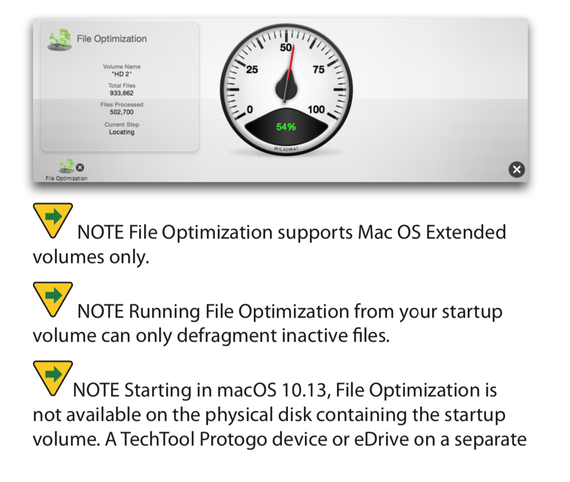

After reformatting my hard drive from APFS to HFS successfully .
(due to it running far slower as APFS )
I am unable to defragment the hard drive using Tech Tool 13 ( OS Mojave )
as TechTool is saying cannot defragment as drive is APFS ?
any ideas?
Thanks
Perhaps you really didn't reformat the drive as HFS+. Check that. If you did, and TTP says otherwise, perhaps you're not using the latest version of TTP or TTP has a bug. Either way, trying to defragment a hard drive has long been a past practice and isn't done any more on HFS+ volumes because HFS+ defragments automatically behind the scenes. And if you just reformatted, it's not fragmented to begin with. So I would not worry about it and just move on.

I am running another Mac on 10.9.5 which i defragment regularly due to doing a lot of Video and Audio editing and i do find it runs a lot faster after Defragmentation?
I am running TechTool from an external so not from the Drive i am trying to work on
Possibly wrong version of TechTool i am using 13 maybe 14 would work?

Have you checked in disk utility that all partitions are hfs+.
Thanks MarkC426
I will double check in Disk Utility that I have successfully reformatted the Drive
Chabig.
You were right
I checked and is still APFS ?!
Very strange as I def picked the +HFS Mac OS Extended (Journaled)
option after I wiped the drive ?
