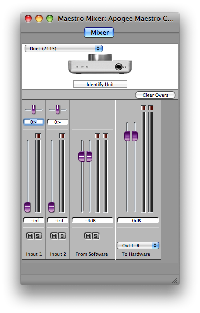

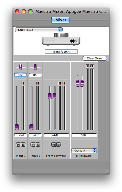

About the red lights and clipping, that drove me crazy for a while but then I tried calibrating my Apogee Maestro and I was able to lower the decibels and eliminate the clipping but still get the volume I wanted.
Here is a screen shot of how I have my Duet set on my Apogee Maestro Mixer, basically turn down the decibels from the software to -4dB and leave the to hardware at 0dB.
edit- I also lower the volume control within iTunes just so I don't risk blowing out my sound card in my Macintosh.

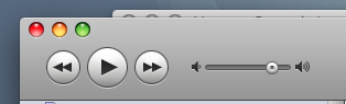

I don't own a Duet, but I know its common advice to keep your iTunes volume around 75% or so if you're driving another device (in this case the Duet). Otherwise you overload the input, causing the clipping.

Awesome glad to have helped 🙂 From what I remember the only volume you should ever max is the final one in the chain (i.e. the speakers). I have my Tannoy monitors maxed, but then have my Mbox volume variable and my itunes at about 75%, this seems to work for me!

Run iTunes at 100% - otherwise the iTunes volume control is interfering with the signal. When it's at 100%, it's not adding or subtracting anything from the signal. If the clip light comes on when playing music, then it means there's clipping on the recording.
The sort of clipping you want to avoid is where the output of your iTunes is actually HIGHER than it should be (higher than 100% basically). Disable the iTunes EQ (any boosting in the iTunes EQ result in distortion/clipping, just like on an iPod/iPhone), and disable the 'Sound Enhancer' (which does just the opposite), and keep the sound check off. Then iTunes will be passing the waveform straight through CoreAudio into the interface.
