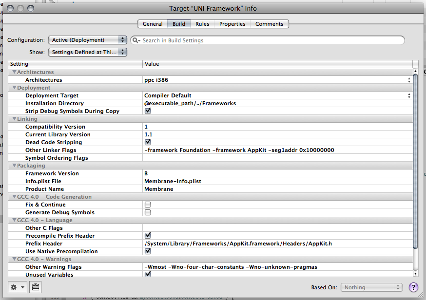

Change the build settings for the framework to look like these, especially the Other Linker Flags specifically the -seg1addr flag.
You can see the all important @executable_parh there too that will solve your problem: it's that setting that tells the system to load it from inside the app not the system frameworks location.
ok mine now looks the same, but what did it do? It didn't solve my problem, I just rebuilt and all that. Please don't just tell me how, tell me why. I found Apple's doc, but it wasn't very helpful.
Without access to the entire thing I don't know what to suggest. The whole framework thing is a little fragile. The @executable_path setting there makes this work by emedding the framework on the app in the correct frameworks folder. Anywhere else and it won't work.
