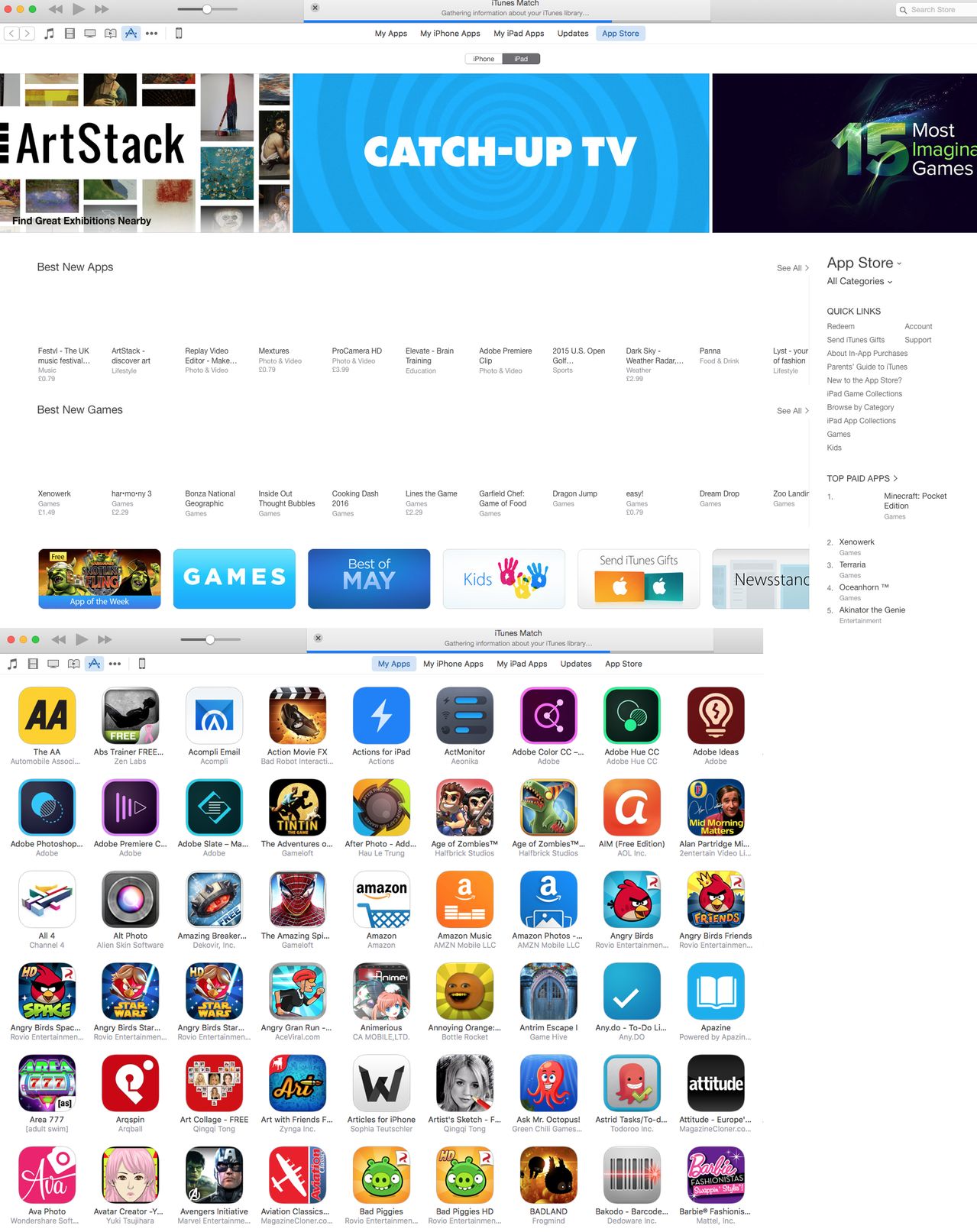

I'm not sure if this is related to El Capitan, but since running it, i have no icons for apps in the iTunes store. They are fine in 'my apps' and music and TV is fine. I've tried 'reset iTunes store cache' and i've started itunes with a clean library, but don't know what else to do. Any ideas? Thanks!

I've tried everything I an think of and just can't get them to display.
