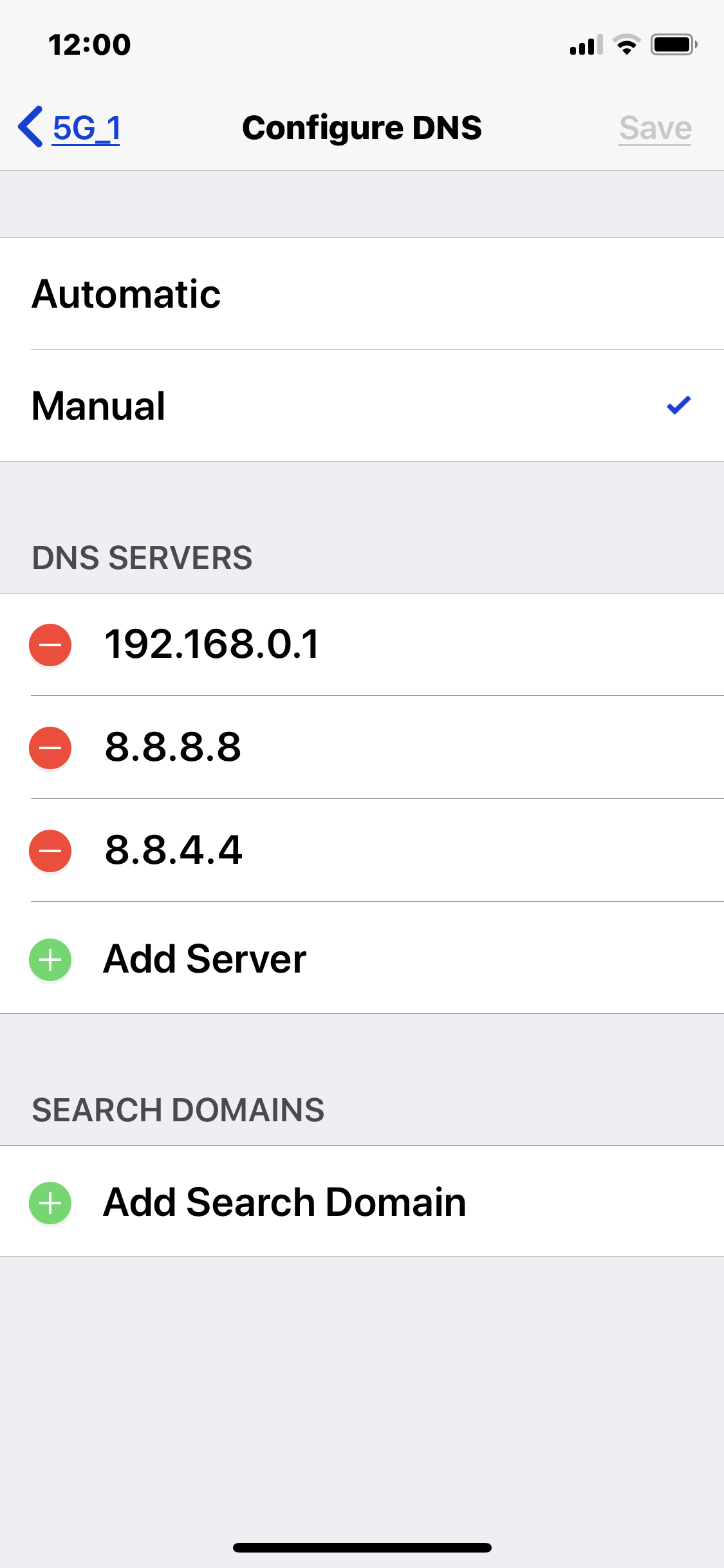

I've had this issue and was able to have a workaround by adding manual DNS servers in (Configure DNS to manual) in WIFI using addresses 8.8.8.8 & 8.8.4.4
Thanks for this! Hasn't entirely solved the issue for me but I'm at least getting updates at trickle speed over my 200Mb fibre line. What a bizarre bug.
