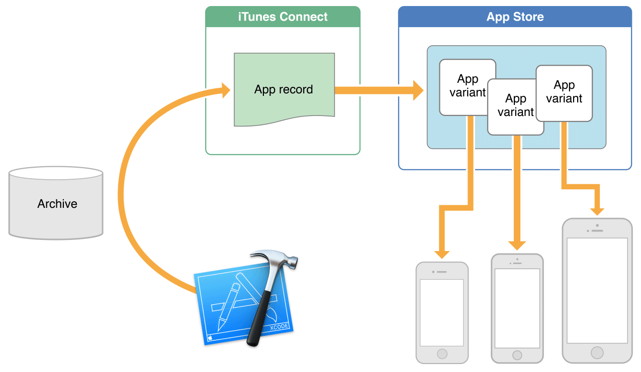

Since you're downloading an "App variant" without universal files it won't sync back to iTunes.
App Thinning sounds like a bad idea to me.
Exactly.
What if the app gets removed from the app store? You'll only have half a game?
As of now, you can still download the full apps directly from iTunes which can be synced to the phone - but they cannot be synced back to iTunes.
Since exclusive iCloud backup users are more likely to benefit from App Thinning, iTunes backup users should at least be able to opt out of it.
Is there a way to tell iTunes to download all the apps that are on the phone?
For example, when I went from my iPhone 5 to my iPhone 6, I did a backup with iTunes, including all apps. Then I restored that backup to the 6. It was a LOT faster than if it had to download all the apps again.
I guess we will be playing the waiting game next upgrade. 🙁
