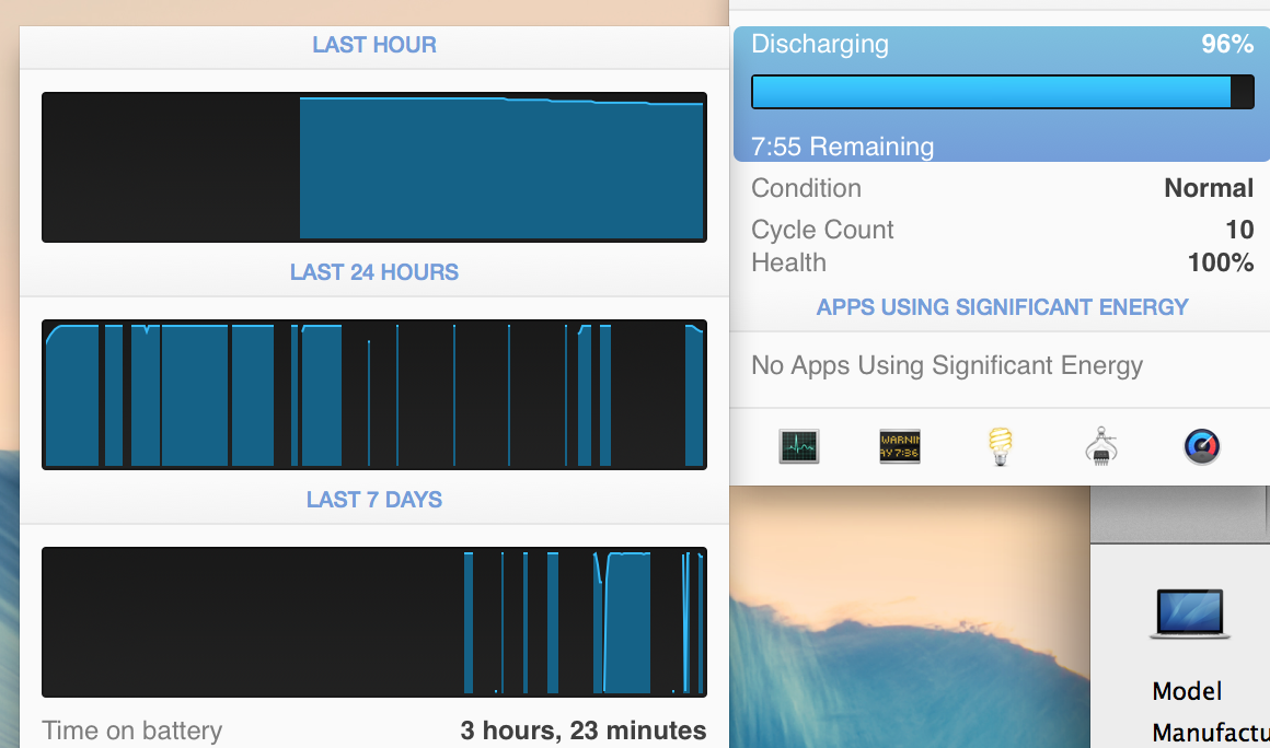

Finding an application that distinguishes between "sleep time" and "usage" will be the challenge. I use iStat Menus and while it displays various battery statistics, the battery drop-down section primarily distinguishes between "time on battery" and "time on charger."
