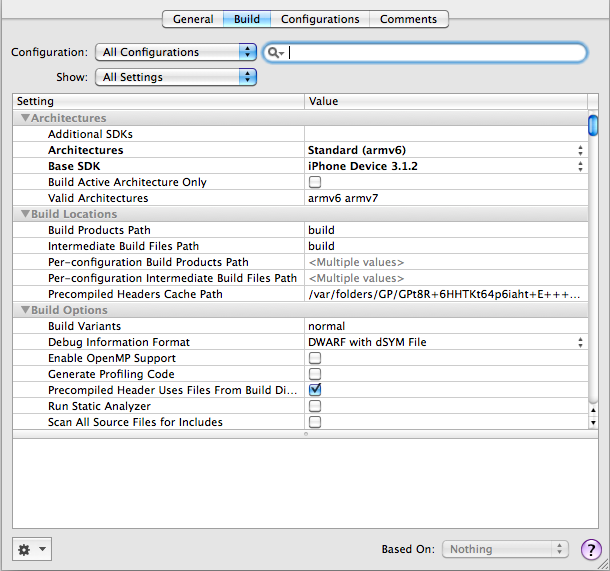

i've built an app and just found that it doesn't run on anything below 3.1.2, when it should have been nothing below 3.0.
looking at the screengrab of the project "get info", am i correct in saying that i should change the "base SDK" from 3.1.2 to 3.0 ?
No.
Set Base SDK to the highest OS that you support, 3.1.2 in this case. Set iPhone OS Deployment target to the lowest OS that you support, 3.0 in this case.
You would need runtime checks in the code for any features introduced after 3.0 that you use.
