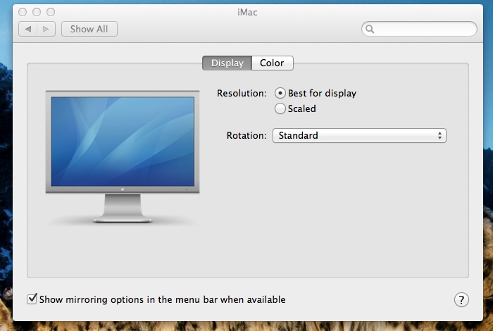

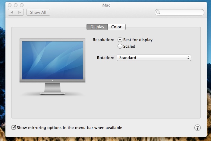

to those of you that have your 24inch cinema display functioning perfectly with your mac pro, are you able to control the brightness with the keyboard? for some reason i can not control the brightness via the keyboard and system preferences.. i had to download a separate program called "shades" just to adjust it. i prefer to control it the normal way. any suggestions?
PRAM zap could help. restart holding down cmmd-opt-p-r for 3 boot chimes and release. Unplug and plug back in display and keyboard if wired. Does the display system prefs allow to control brightness because those are usually not working either if it is a driver issue? Are they keys mapped incorrectly? Do you need to use 'fn'? F keys could be mapped somewhere else. Or try mapping other keys?
There is no setting in system preferences for brightness. on my imac i have the slider bar but on the mac pro with the cinema display there is no slider bar. I did a PRAM zap a couple days before i got the display, would have that helped or should i do it again? I read up that this is a common issue but i have not been able to fix it. I would assume its software related. because everything else works; isight, speakers and usb hubs. I dont know what else would be causing this

Yeah. It isn't recognizing it as an Apple display at all. Just generic.
I would try another Mac and see if there is a firmware update available ( I know there were a few) and apply on a Macbook or something and then re-attach. Otherwise take it into Apple repair place. If it is same story on another Mac it's the display. If it works on another Mac maybe a re-install of your Mac Pro OS could help?
i plugged it into my 2009 imac and i had the same issue on there as well, How would i go about getting the proper firmware for it to work? is a new install of the OS the only route to take to fix this?
Unfortunately you may need to take it in. If it wont register as being there you can't upload correct or changed firmware. Won't even know if firmware is available. Doesn't appear to be SW from what you are stating. OS wont fix it if it isn't being recognized on any Mac.

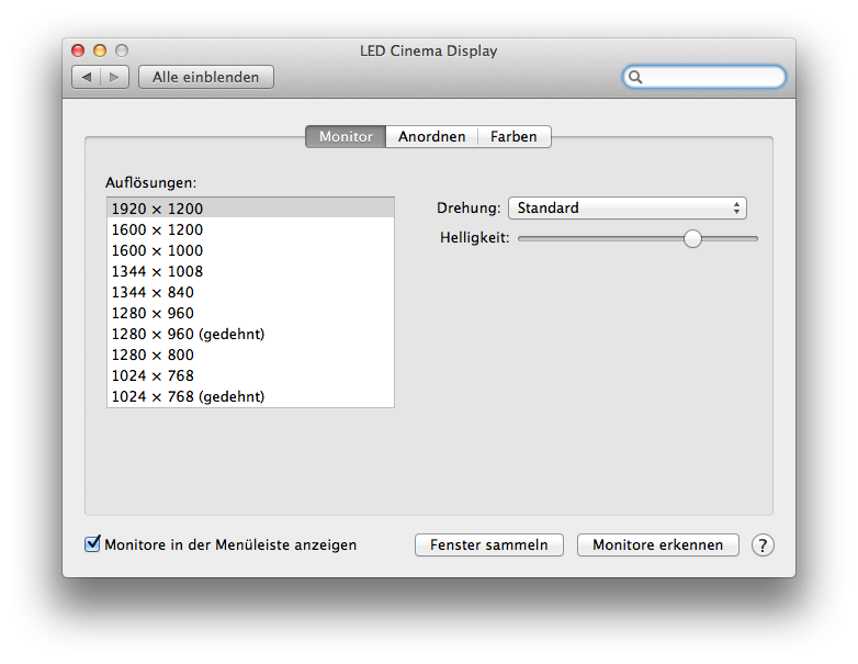

Yes I am. Early 2009 Mac Pro running Lion, 24" ACD connected to an Apple 5770 using one of two MDPs. No flickering either since I bought it (hardly) used in 2011 btw, and almost no reflections when set up at the right place. I'm quite happy with it.
Below is what you should see in prefs. I have a 19" Sony SDM-HS93 connected to it as second monitor via DVI/VGA adapter, thats why the "Arrange" tab is also there.
