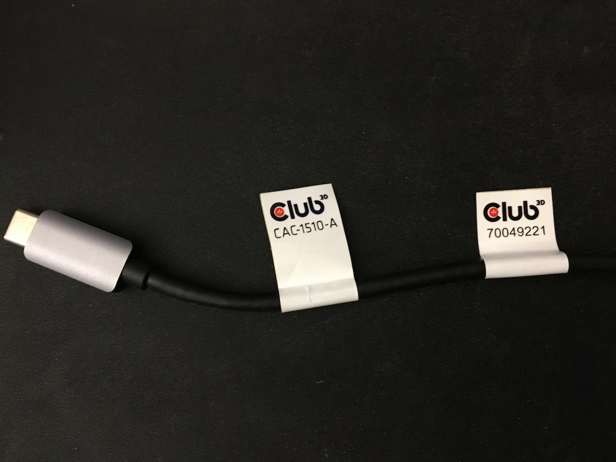

I have a Mac mini M2 Pro and Lenovo T470S, they both are working with 30" Apple Cinema Display, using The Club 3D CAC-1510-A is a USB3.2 Gen1 Type-C input to Dual Link DVI-D or Single Link DVI output adapter HDCP OFF version for Apple Cinema Displays. HDCP OFF version is important!!!!!!!!

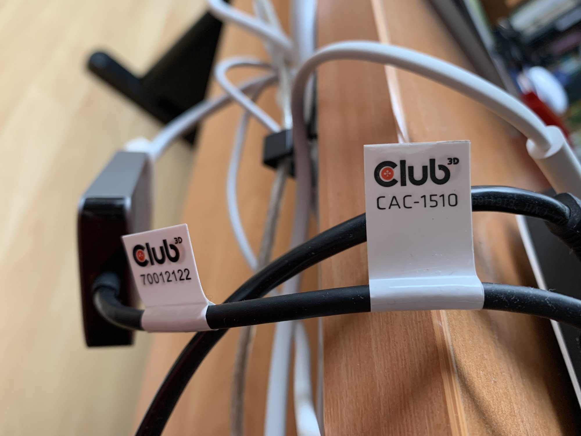

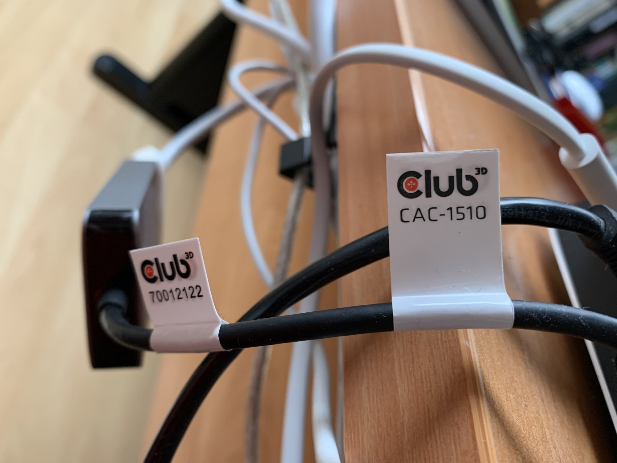

I just bought a second 30" ACD and so I will check if this needs the 1510 or the 1510-A ? or how can the adapters be distinguished?
If you test an 30" ACD keep in Mind you have to power usb too in order to keep the monitor working. Luke reminded this too.
I have the HDCP OFF. But I have not tested with usb power too. The screen started, but only functions properly in half resolution

OK, so we have it.
1510-A = HDCP-OFF
1510 = HDCP-ON
