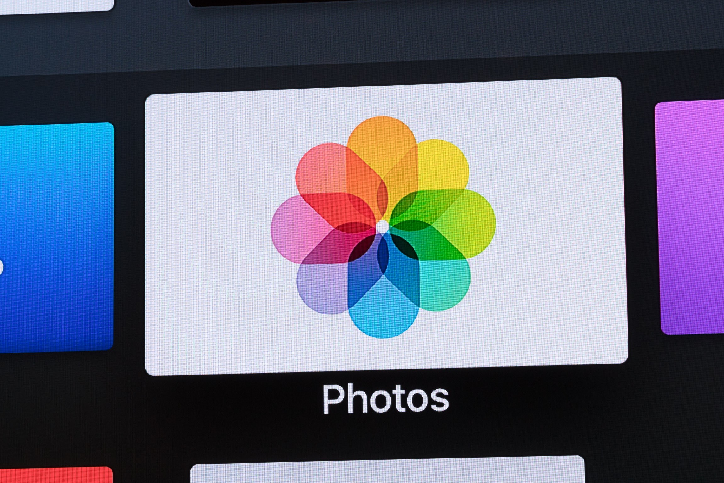

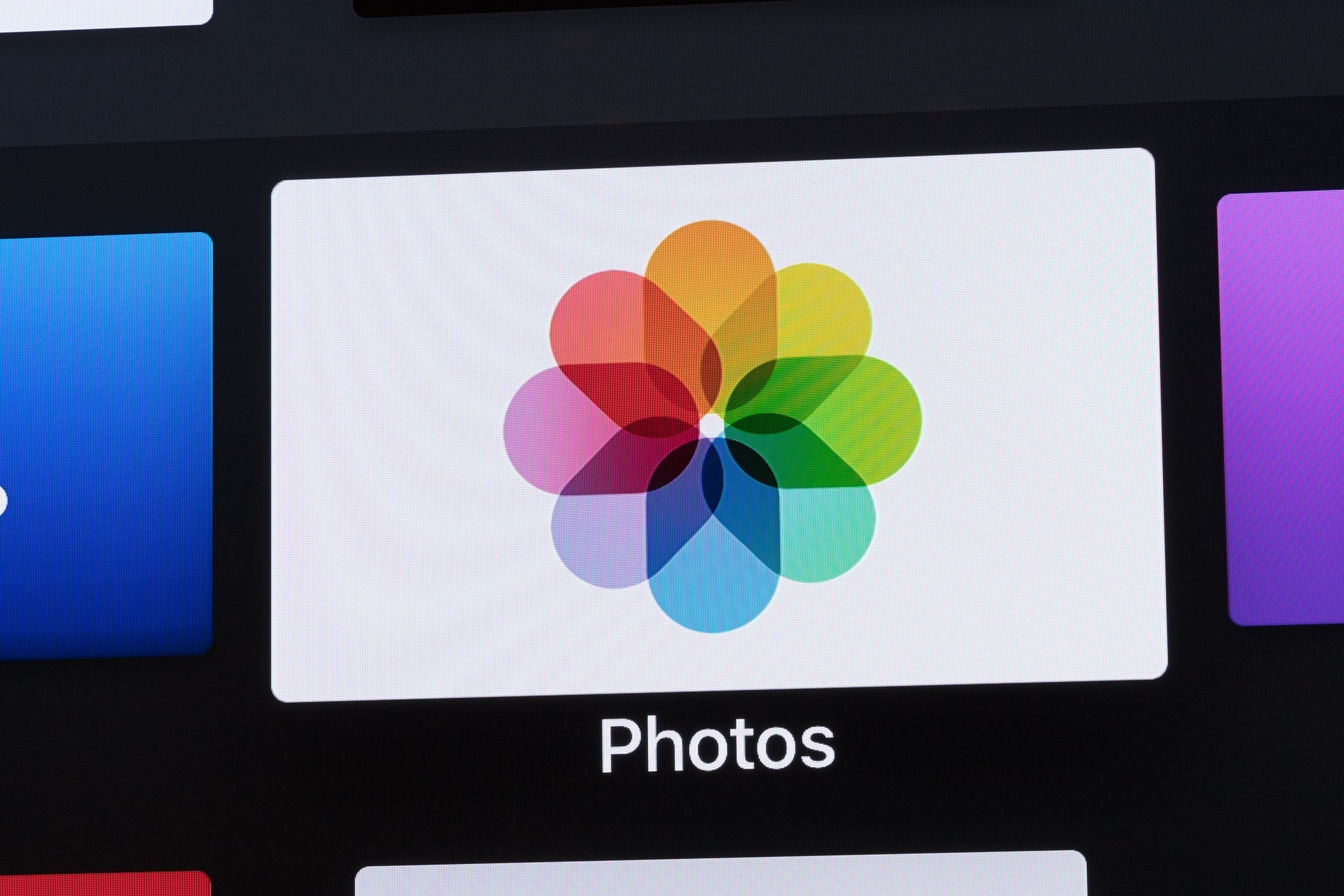

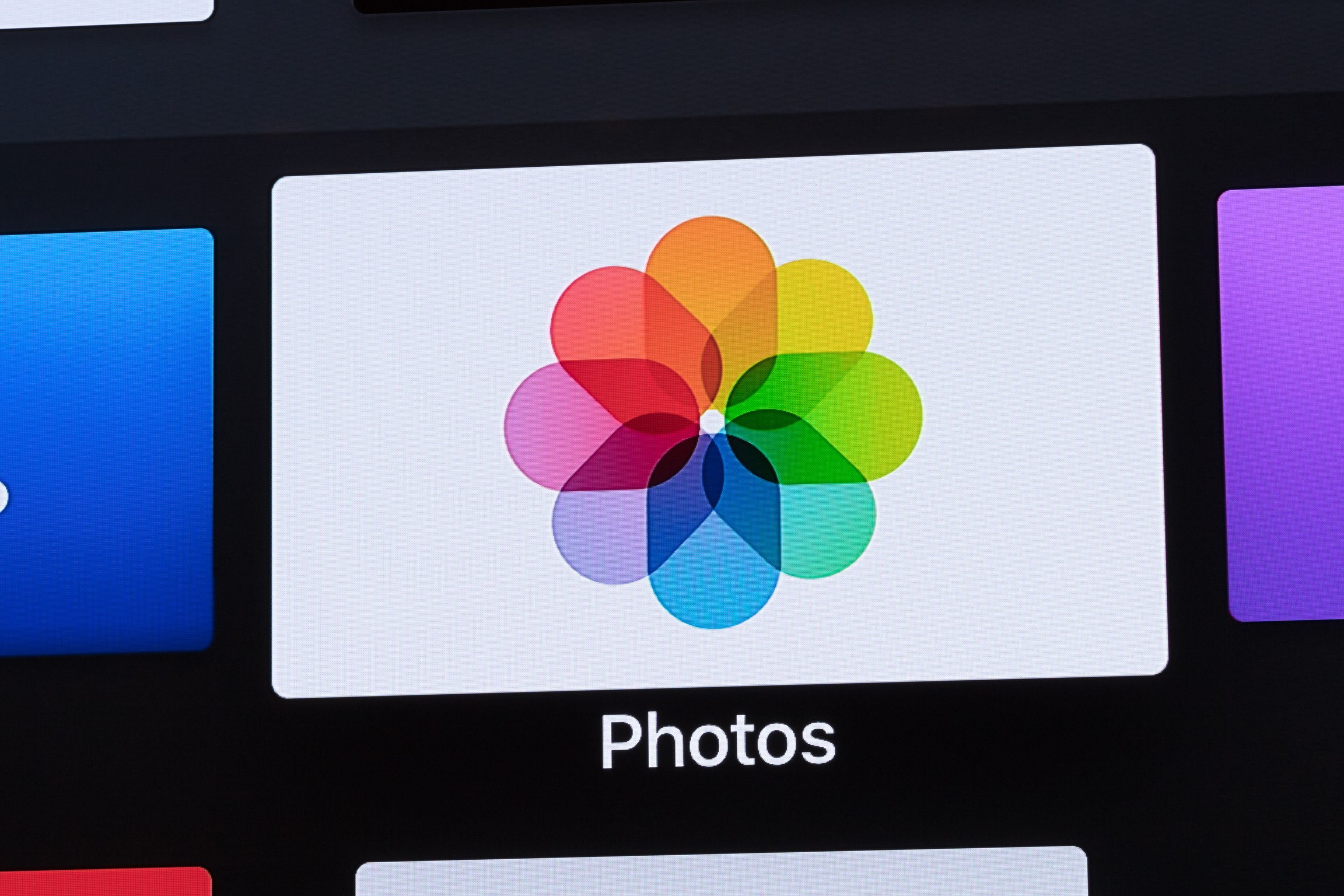

I have an LG OLED C7 television. I got the new Apple TV 4K today, and when I turned it on, I noticed that the colors are somewhat dull.
I know the third party apps haven't been updated to support HDR yet, but even on the first party home screen icons, I notice a difference.
Is this supposed to be the case? Are the Dolby Vision colors more accurate, and that I'm just not used to them?
Dolby Vision
4K HDR 60Hz
4K SDR 60 Hz
