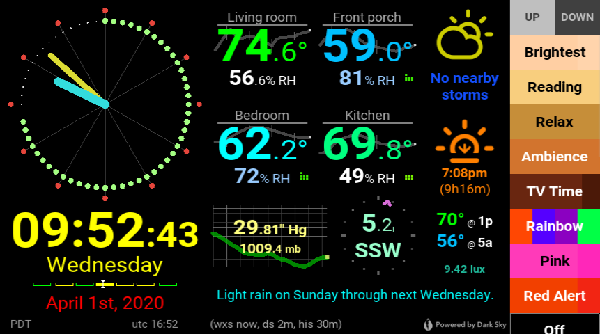

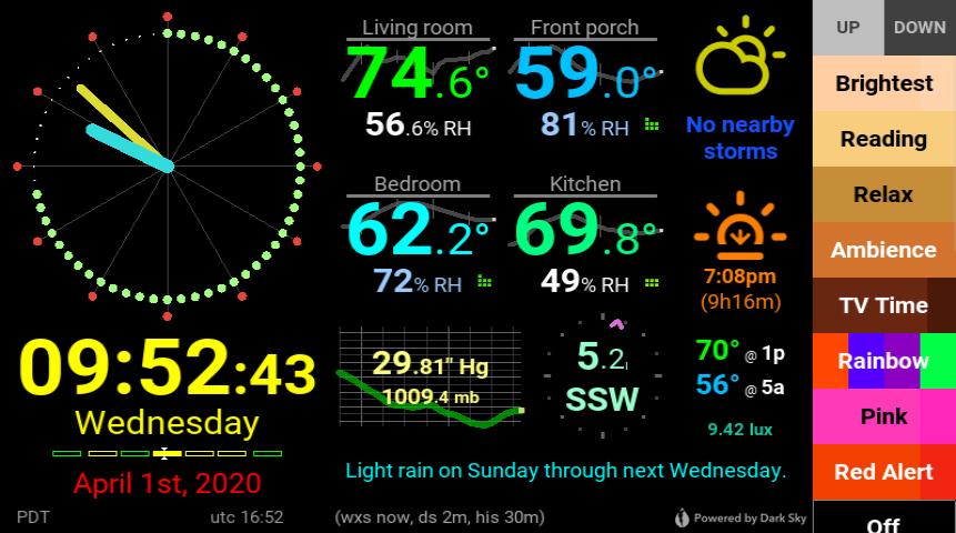

Here's a screenshot of the main touch panel display (the stripe down the right edge are touch controls for the Hue lights):

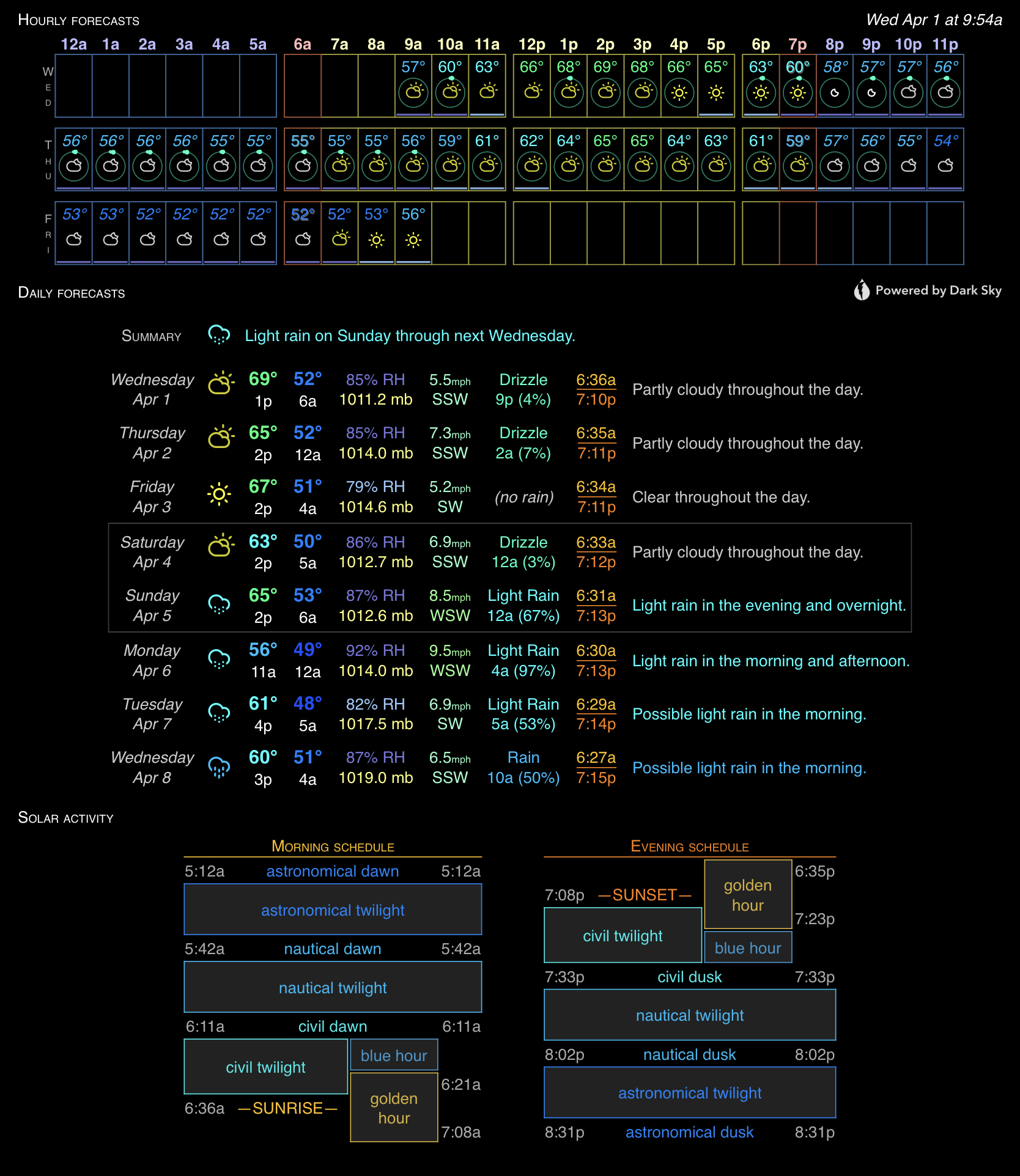

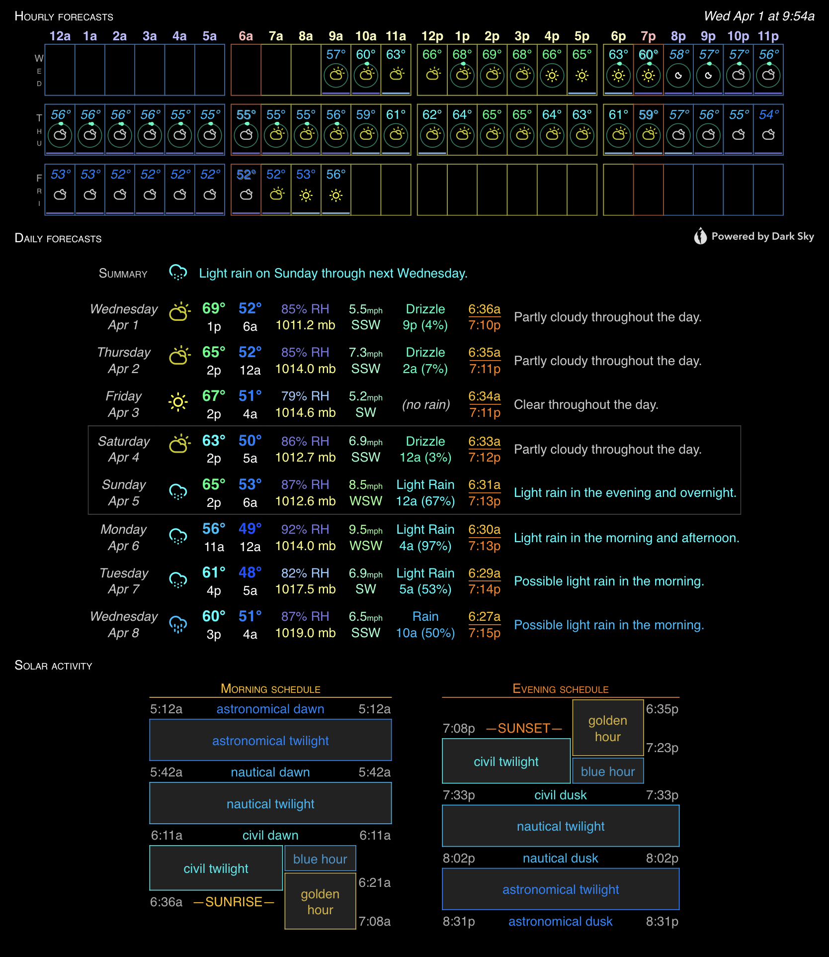

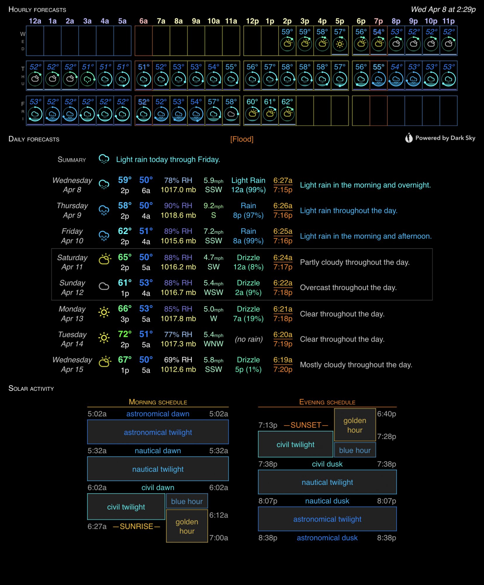

And this is a web page that (aside from the sunrise/set info at the bottom) is essentially a compact visual translation of the interesting bits of the Dark Sky forecast information:
