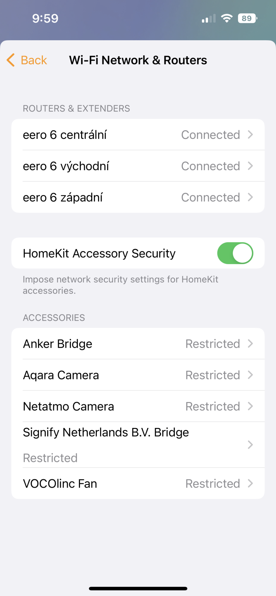

If you have constant troubles with HK, I suggest you to get HK compatible router, like Eero 6. 15 HK devices, running HKSV, zero issues since I got it.
I am not sure there is such a thing as a “HomeKit compatible router” specifically.
Can you share what makes you believe this is the case?

It appears in Home app and you can restrict access to all accesories that communicate through the Internet when it’s not necessary or unwanted. I don’t need my cams to call home when I am using them exclusively in HKSV.

The poster is referring to https://support.apple.com/en-us/HT210544 but I don't believe there is any reason to expect that routers that support this feature are any more "reliable" for HK than alternatives. Of course there are so many bugs and design flaws in HK, and so few reliable logging/error tracking mechanisms that WTF knows?
HomeKit works with literally any WiFi.
Some routers offer extra features *with* HomeKit.
For reliability all you need is a solid signal and keep your router firmware updated.
Also - many HomeKit devices don’t use WiFi - many use things such as Bluetooth, Zigby, ZWave, or now - Thread.
Don’t confuse the fact that a WiFi device is called a “Router” and there are also HomeKit “routers” or Thread “routers”. The word “router” is overloaded in these various contexts.
However - some WiFi routers are better and more reliable than others, and if you have a weak or flaky WiFi setup you should not expect your stuff to work well, including but not limited to HomeKit.
You can do this with almost every WiFi router in existence since the late 90s.
These just have a fancy button in the UI labeled “HomeKit”.
I would bet all it does is turn on and off firewall rules, or _maybe_ does that _and_ sends a particular message to the device…
