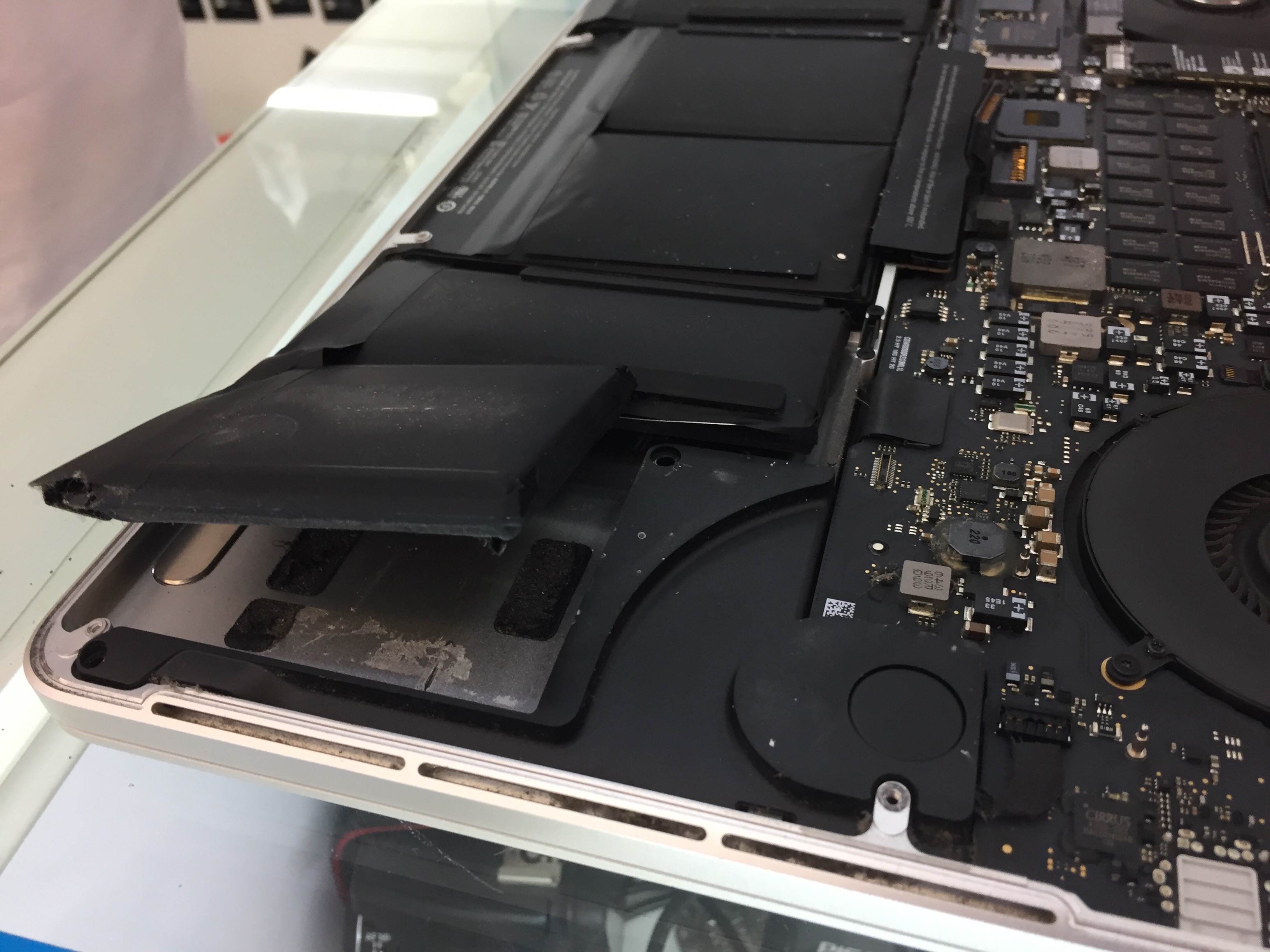

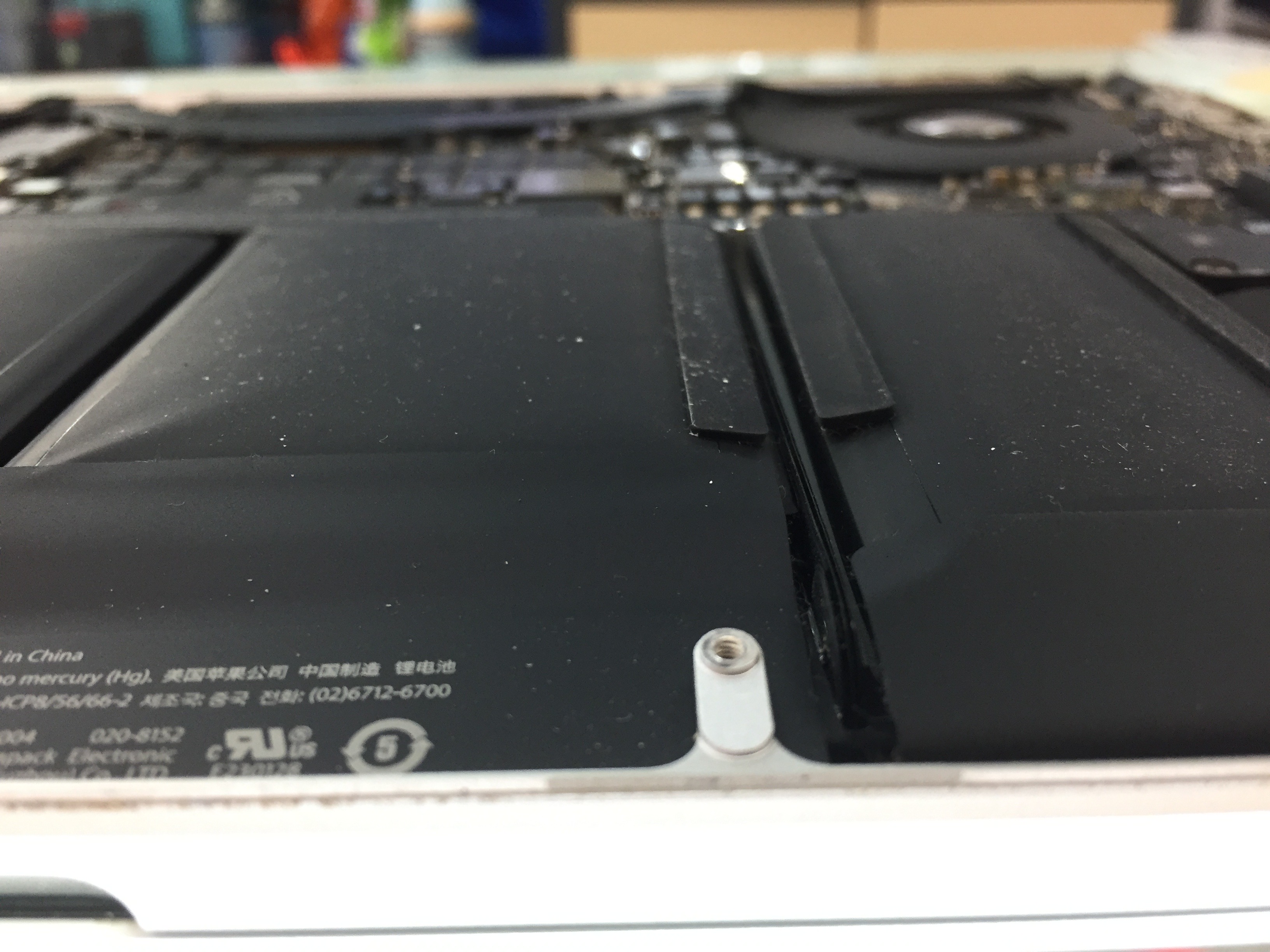

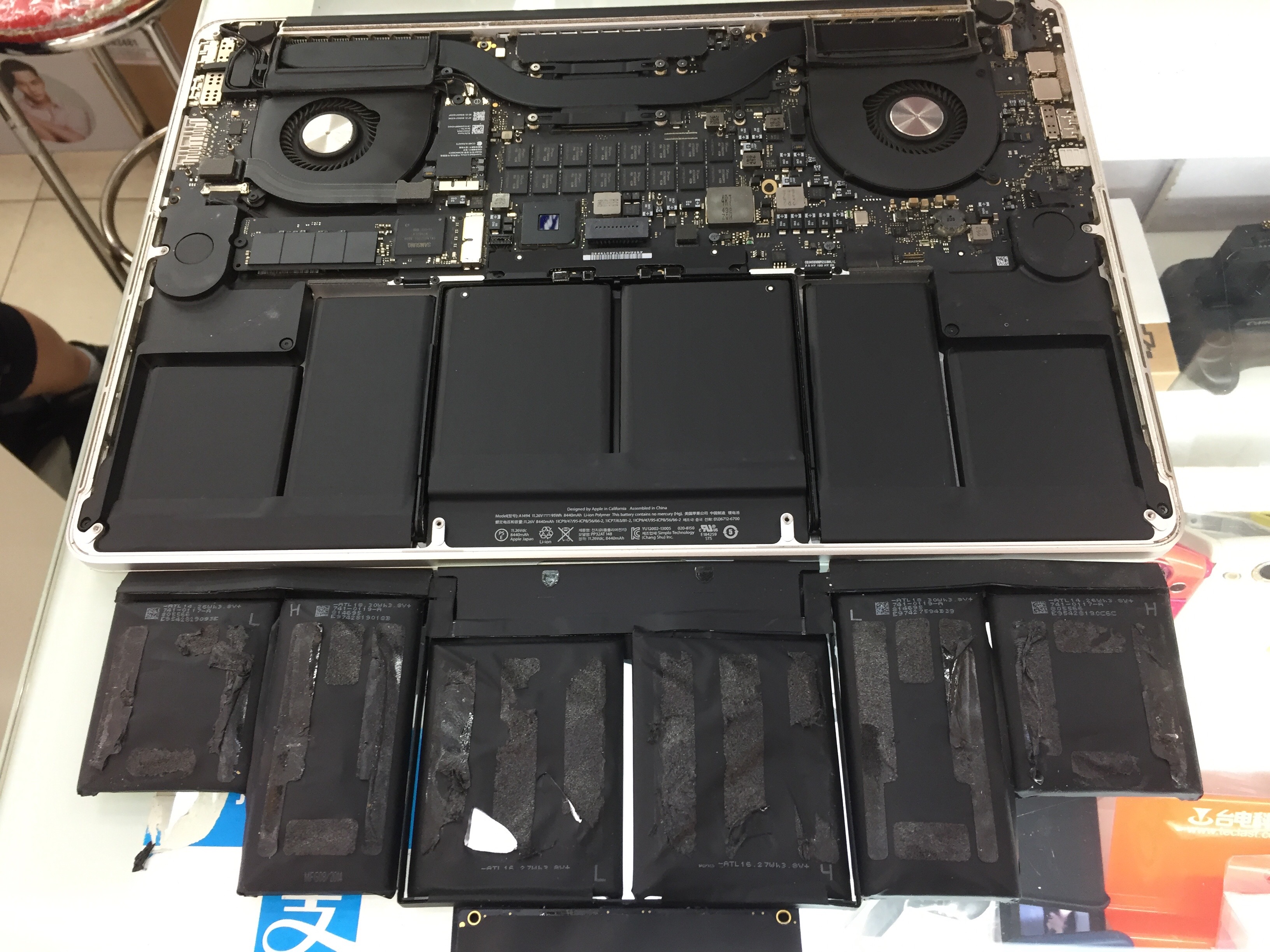

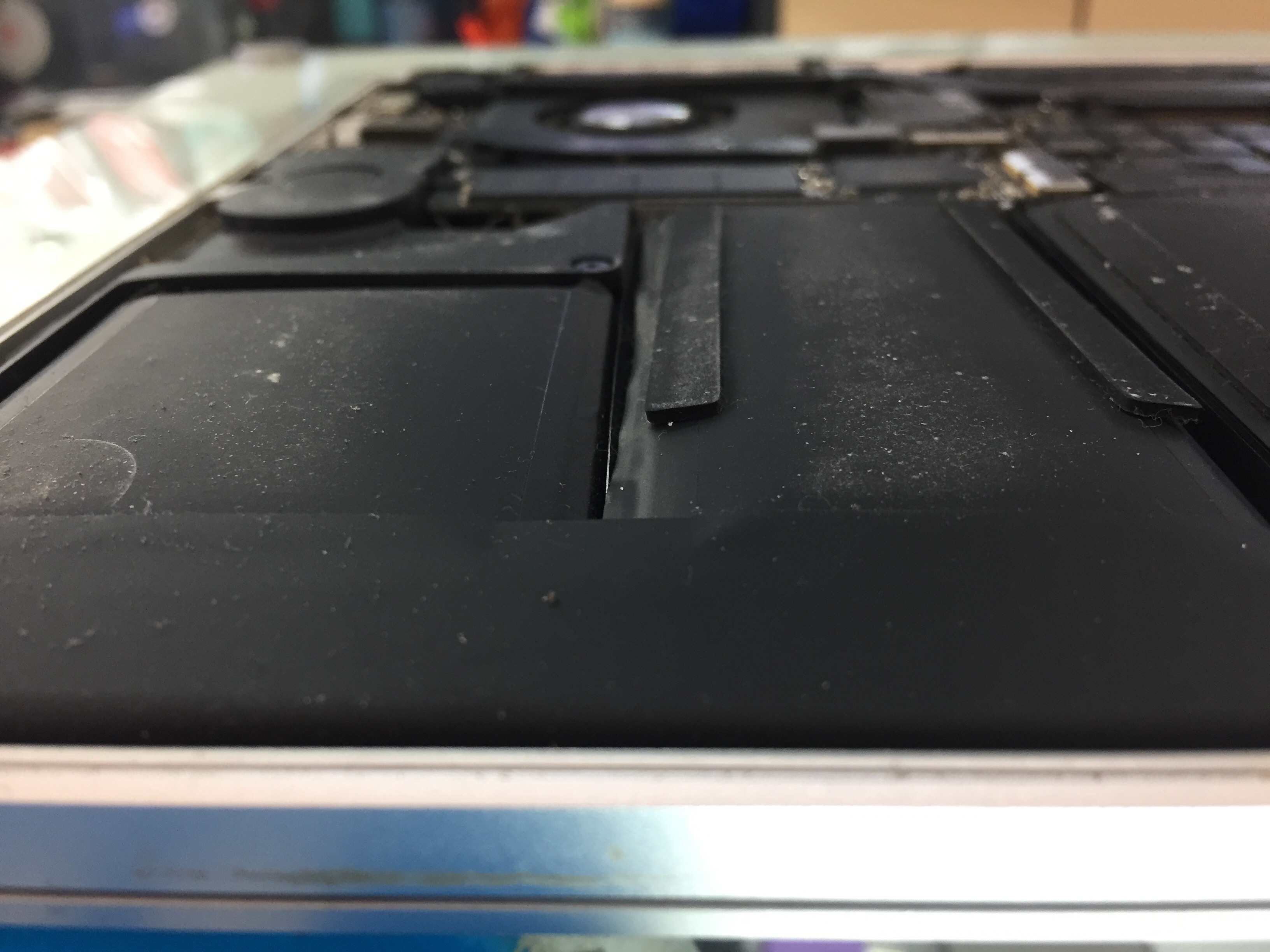

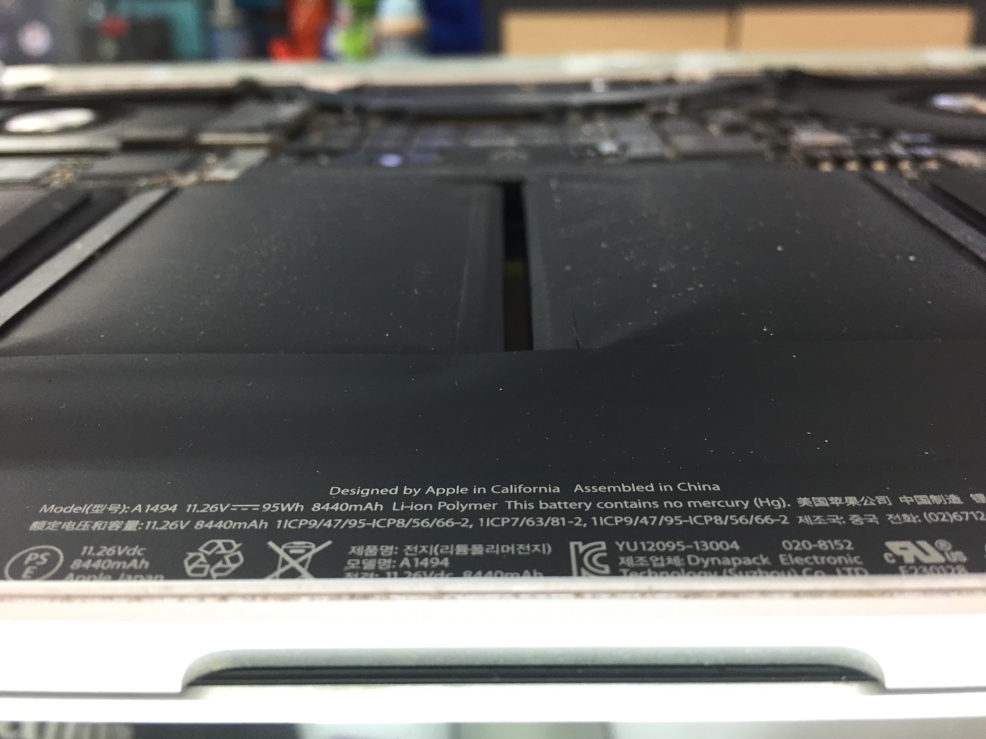

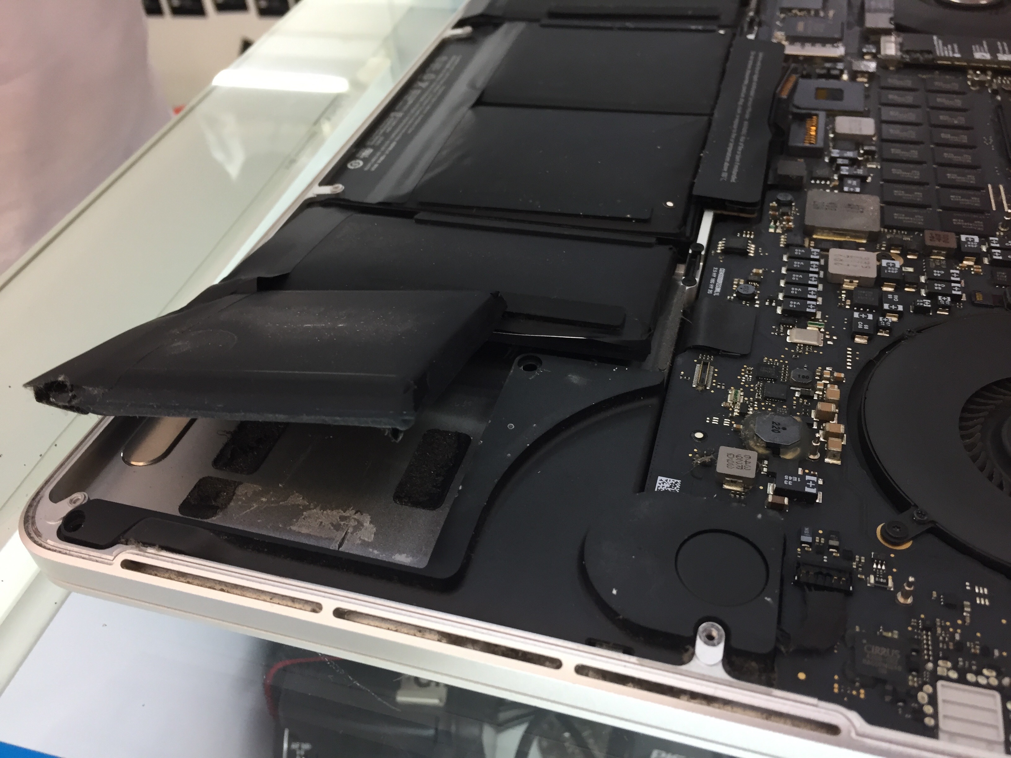

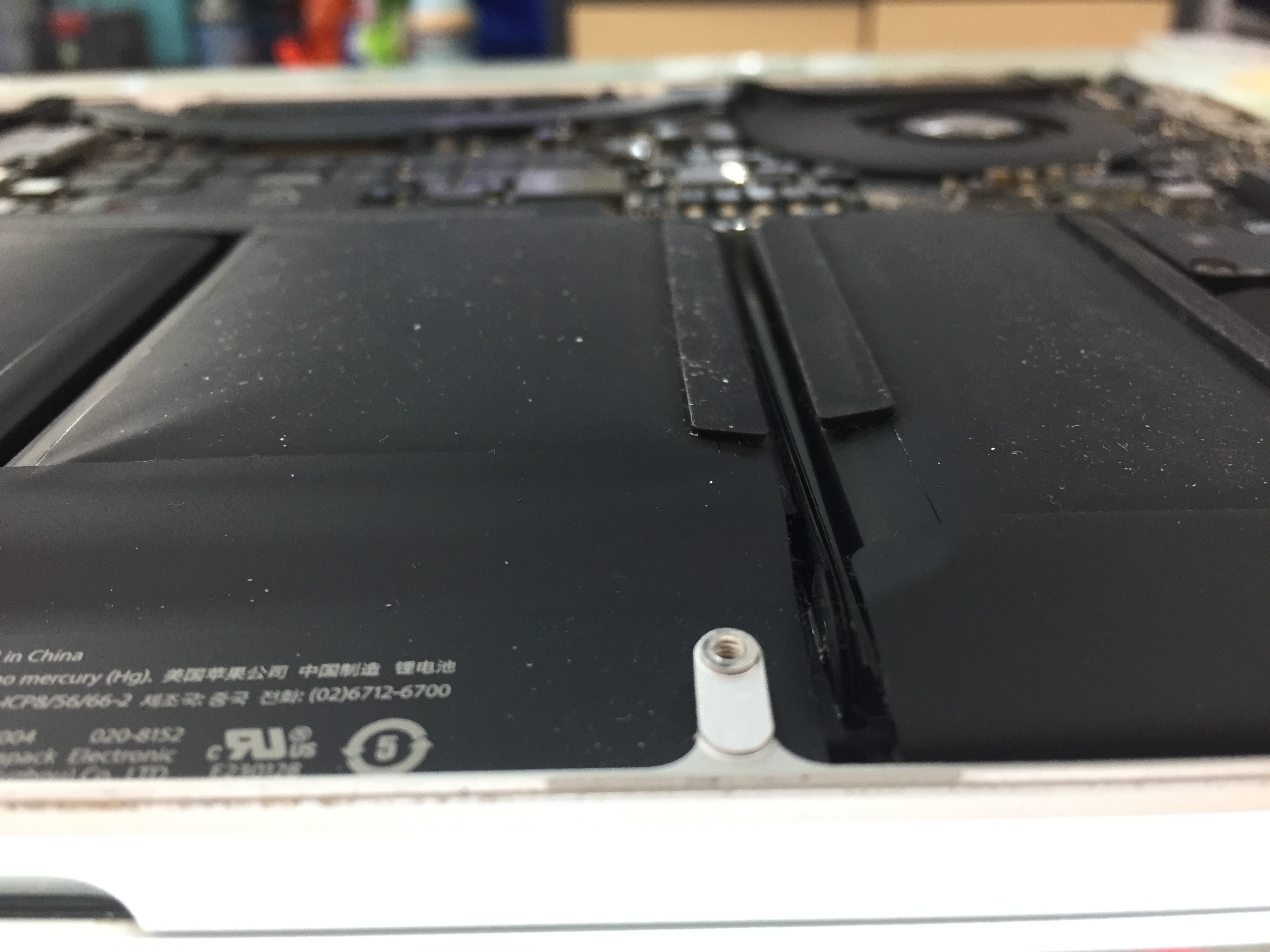

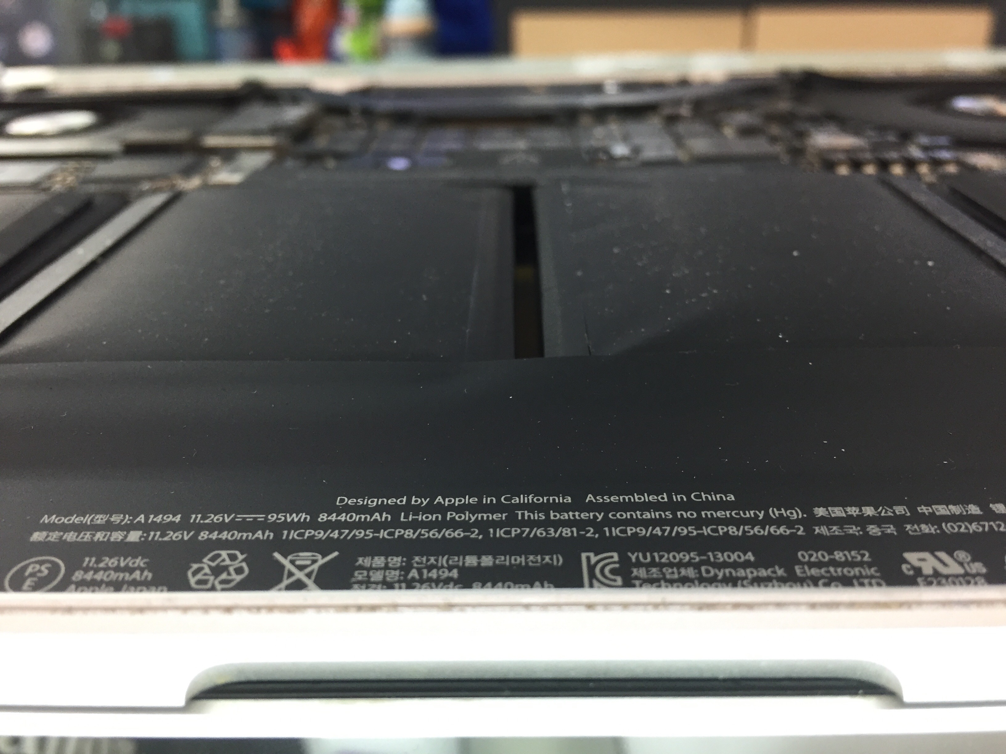

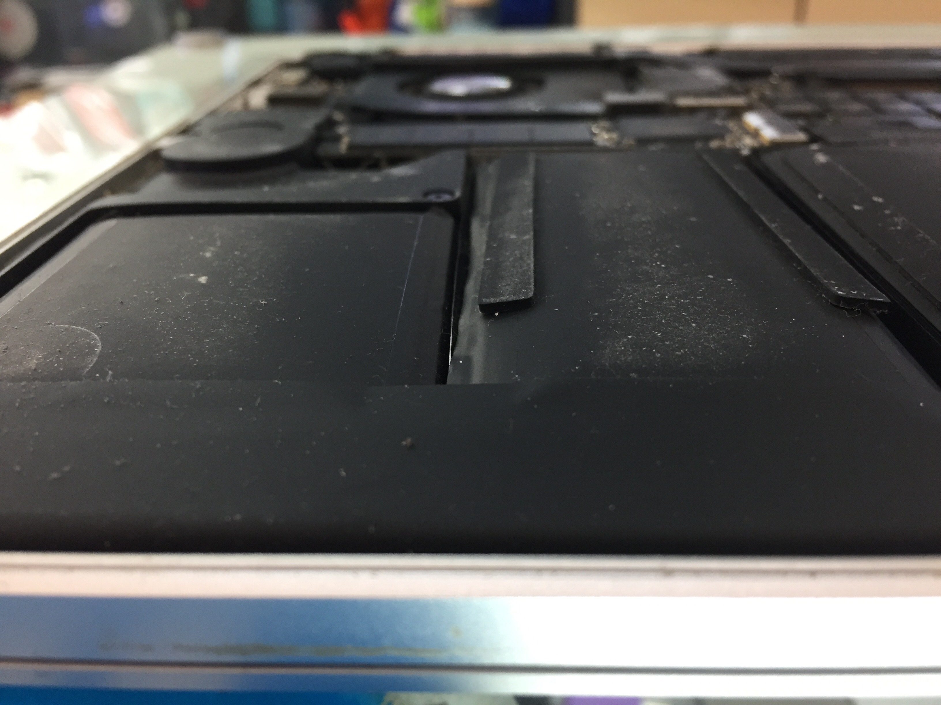

[doublepost=1502540297][/doublepost]Here the inflated MacBook battery. They are fixed with double-sided tape to the top of the housing, rather tedious work to cleanly remove. Don't try this at home. All of the "bags" were inflated, gassy.

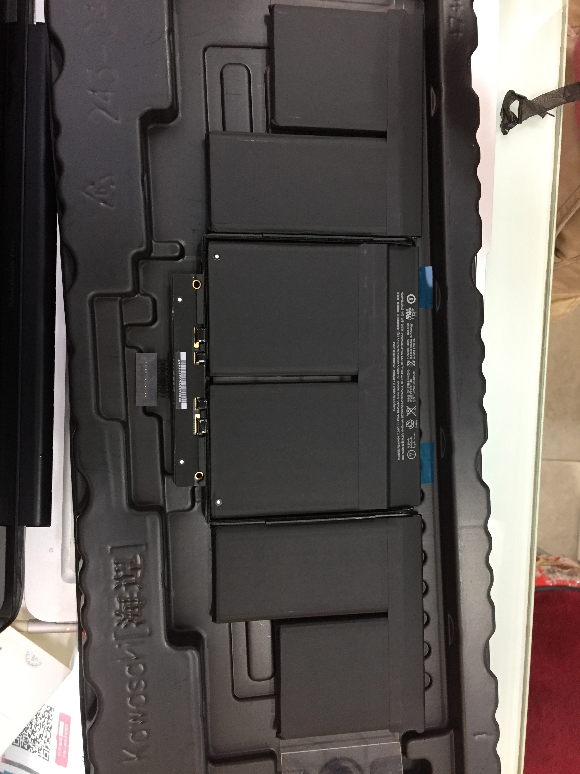

The new battery and the new battery fit with the old battery for comparison:

Frankly, when my MacBook trackpad became inoperable, the very last thing I would have suspected would have been a failing battery. The battery sensors showed health rate 90%. My previous experience of changing a battery was a hard-case battery of a MacBook Air. I wouldn't have known that this MacBook Pro had a battery of flexible plastic bags.
Only when googling the issue of the trackpad and finding a relevant thread on macrumors.com I became aware, that it must be from an inflated battery, a tip for which I am very grateful.
