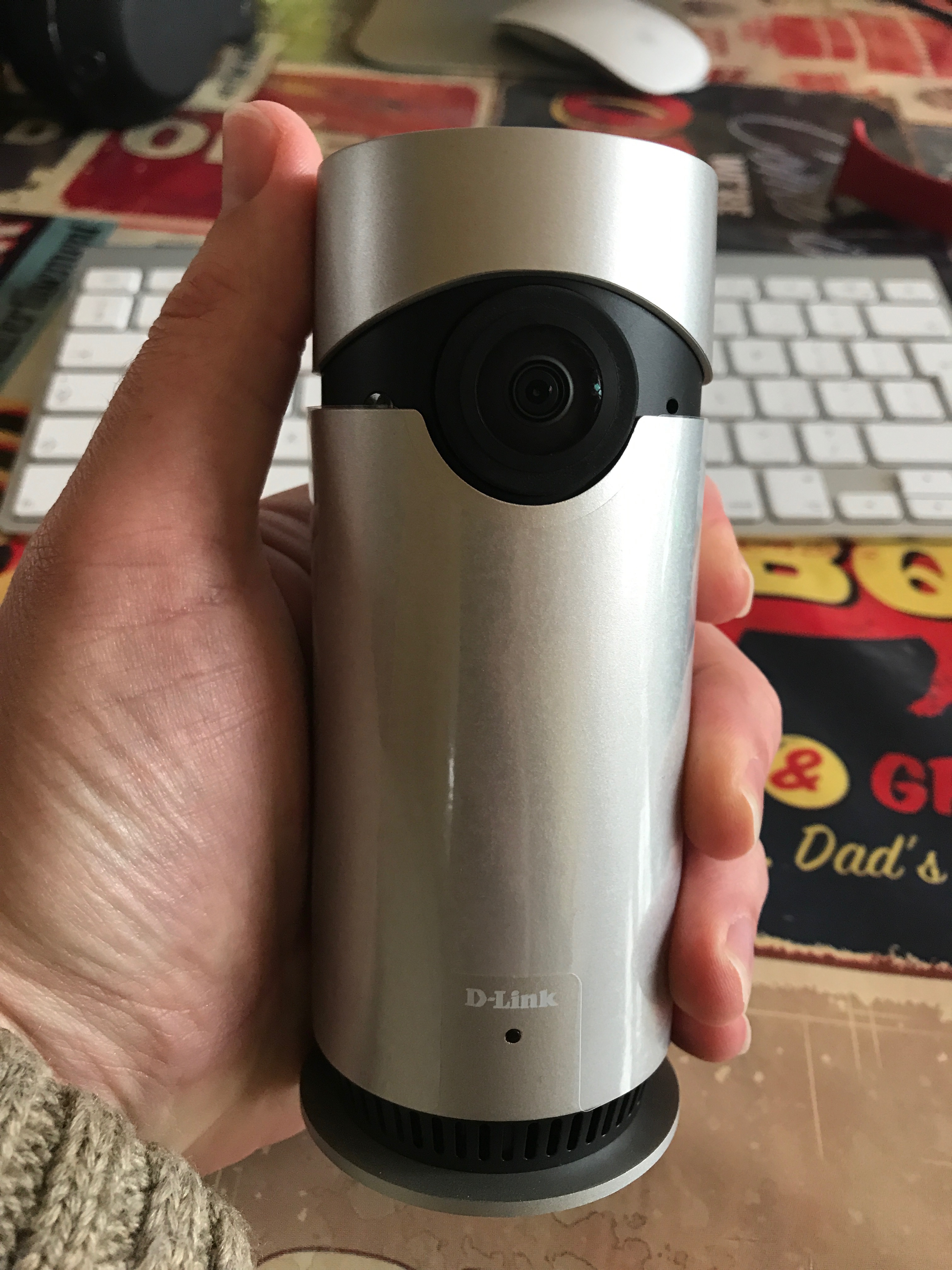

It's arrived.

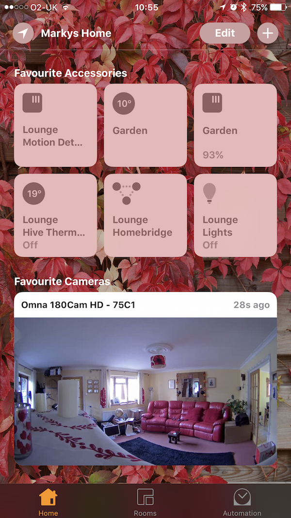

[doublepost=1487242646][/doublepost]Added to the Omna/Home app within 30 seconds, same as other homekit devices.
You get a preview of the camera in the main Home App screen, so no need to open up the Omna app.
The wide angle lens is very impressive, captures the entire width of my lounge with both entrances.

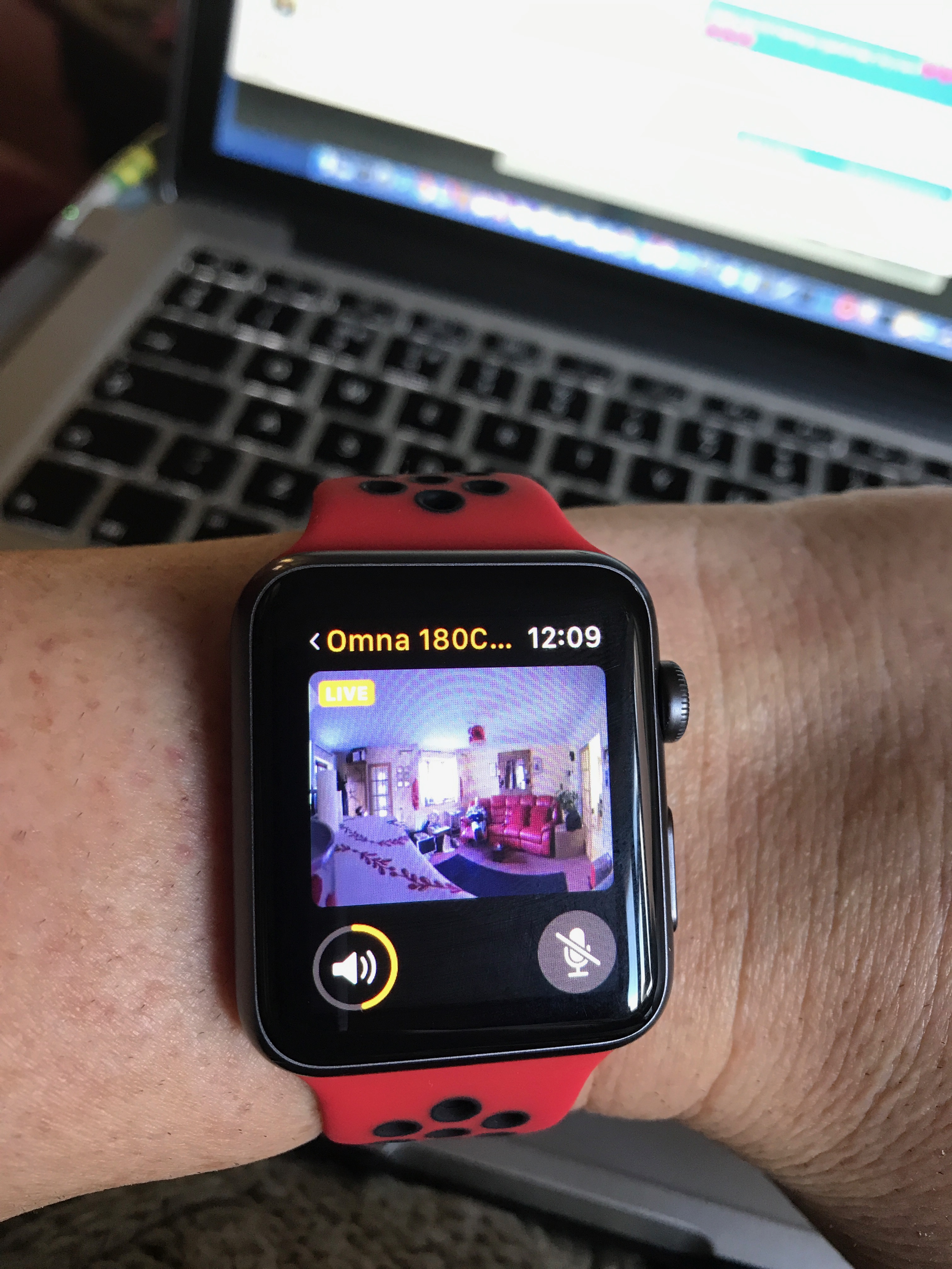

Can see the camera on my watch too.

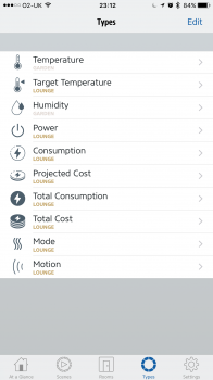

In the Eve app, you can see the Sensor as separate, but you have no control over it.
I'll download the myHome+ app later and give that a go.
Live Feed. It's a still image (taken that very second) until you touch it, then it goes full screen live. (with audio)

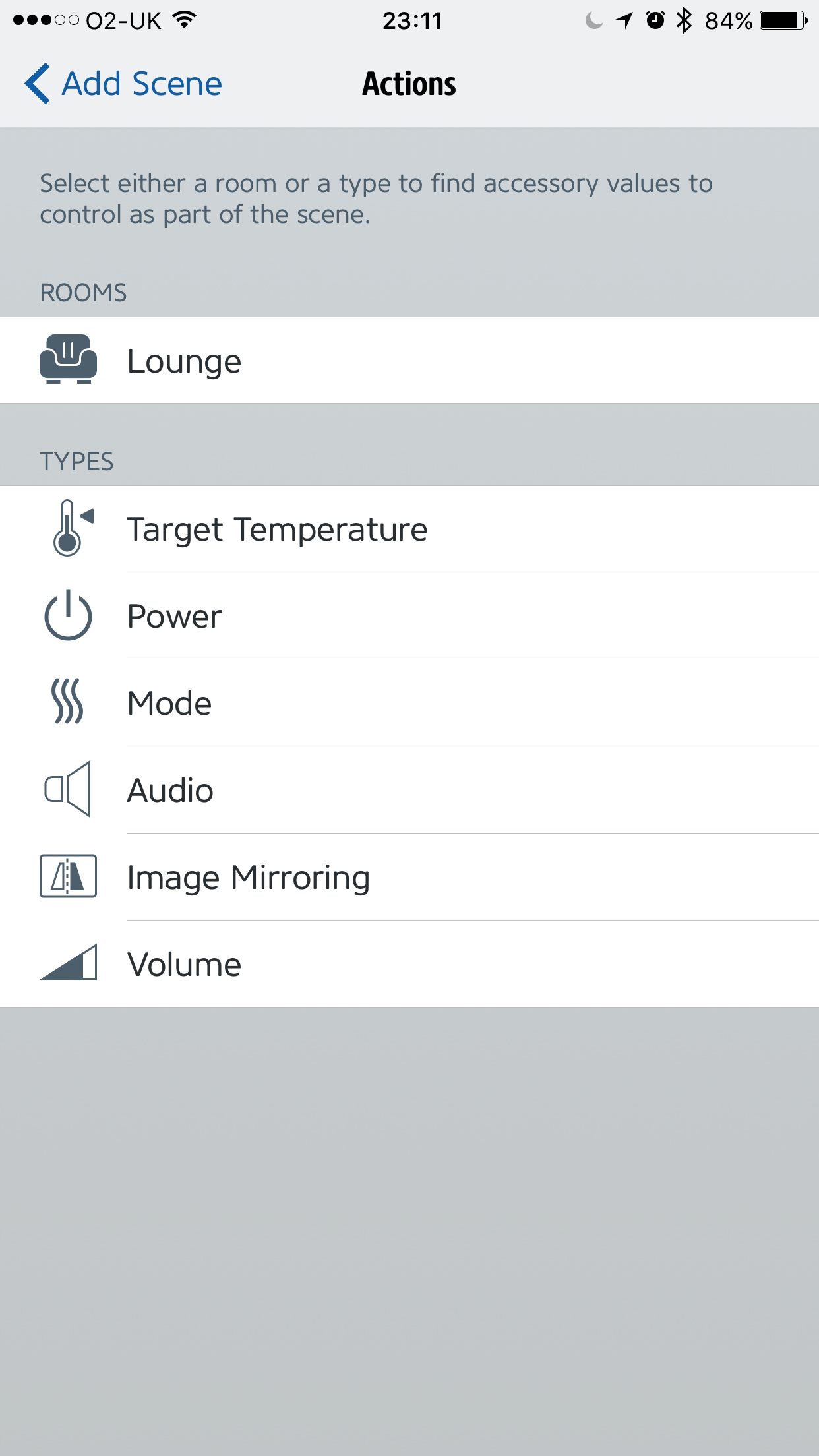

In the eve app you should do the following to achieve, on/off motion sensor when away/home based on your location:
Step 1:
Select Scenes (left from Rooms)
Then Add Scene
Add Actions
Then under Types choose Enabled
Enable your the Omna Sensor and choose OFF (this would be your chose when at home)
Then choose Add top right
Then choose Next top right
Then choose whatever name for this Scene for example: Arrive Home
Then choose Done top right
Step 3:
choose Rules top screen next to scenes and timers
Then Add Rule
Choose Next top right
Then Add Location trigger
Then when asked allow location service
Next select your location
Then choose Next and Next
Then select the Arrive Home scene you created in first step
Then name this Rule to whatever for example Arrive Home Switch Off Motion
Then Done
Now whenever your enter your location it will disable motion detection
Now do the same vica versa for leaving home.
Lestercity. That doesn't work. Although you can see the sensor, it is not accessible in scenes.
I tried the myHome+ app, you can't control the sensor from there either.
The only thing you can do with the sensor is to say, when motion detected, turn on the lights. That's it. No independent control of turning it off or on.
