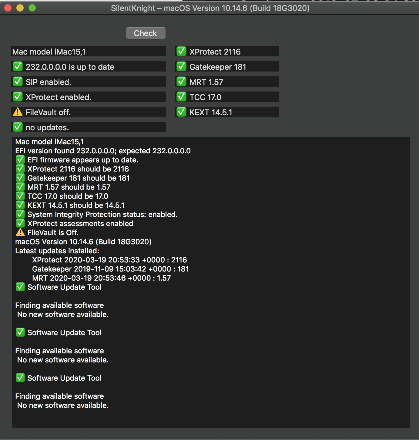

I have a slightly older iMac, the 13,2 model, and it has an EFI firmware higher than yours. Can you run the freeware SilentKnight to see what the firmware should be? <https://eclecticlight.co/2019/07/15...ienc-for-checking-and-updating-security-data/>
On my Mac: Mac model iMac13,2
EFI version found 289.0.0.0.0; expected 289.0.0.0.0
✅ EFI firmware appears up to date.
SMC Version (system): 2.11f14
I do not know if this will help you fix the real issue. It may be that the blade drive has died or the connection is faulty.
Thanks for reply. I downloaded the tool and it says my EFI is the latest unfortunately. Going to try Catalina now to see if that changes anything
Update:
I installed catalina, made no difference.
