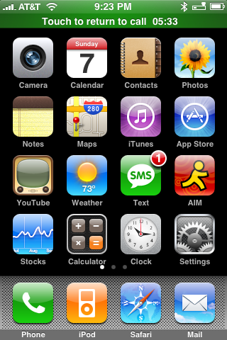

I recently bought the Apple Bluetooth Headset and even after a complete full charge (green indicator), the iPhone headset battery status icon always shows half battery level or lower. It doesn't light up full. After the Headset is charged, it shows a full level but, as soon as I unplug it from the charger it goes back to half? Does anyone else have this problem?

I have the same problem!!!
The battery doesn't get me through the day with only 4 or 5 calls max.
I am very disappointed. I also get a constant buzzy sound.
I only have the headset for one month or so. This is not normal!!!
I will take it back!!!!
My iphone is 2G with firm. 2.1
Any help is appreciated
