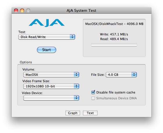

Vertex 3 gives me about 490/460 (sequential) read/write.
