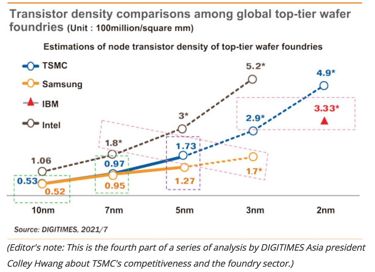

One thing to keep in mind is that these names are just marketing and not representative of the dimensions. Different companies measure things differently. For example, Intel's "10nm" was actually as dense as TSMC's N7 (7nm). That's why they renamed their nodes to be more inline with TSMC (Intel 7,4,3 etc).

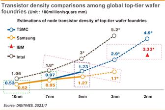

At this point ‘3nm’, ‘2nm’ etc are basically arbitrary labels to describe progress in transistor manufacturing processes. They have little to do with actual feature size on the microchips, which can vary widely in a single microchip.
Also, process sizes are not comparable between different CPU manufacturers because they also serve as marketing tags for that particular manufacturer’s processes.
Don’t base expectations or calculations on the ‘Xnm’ label.

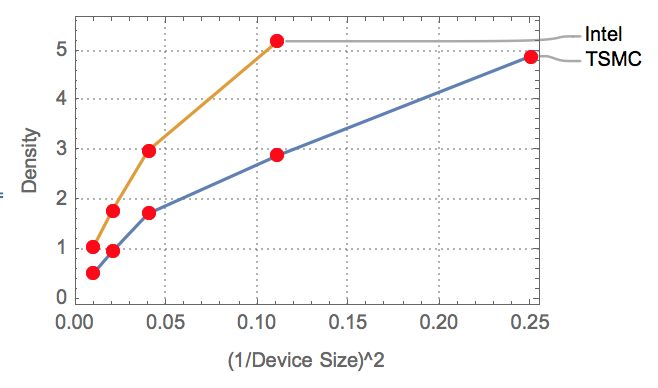

While you can't compare devices sizes between manufacturers, that doesn't mean that metric is arbitrary, since device sizes within a manufacturer are related to average transitor density:
If we replot density vs. 1/(device size)^2 for Intel and TSMC, we see there is a break, so it is not linear across the entire range. But again, it's not meaningless either:
