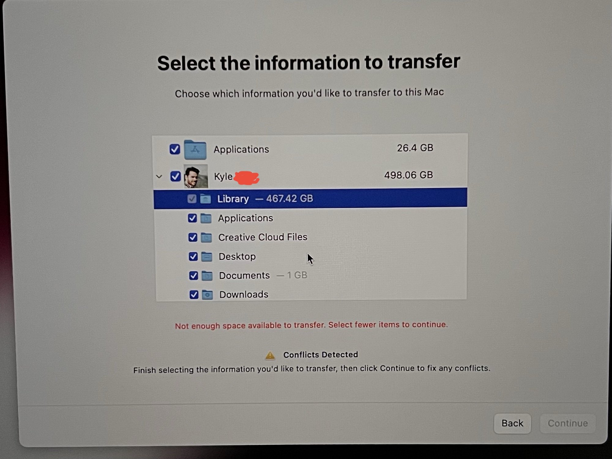

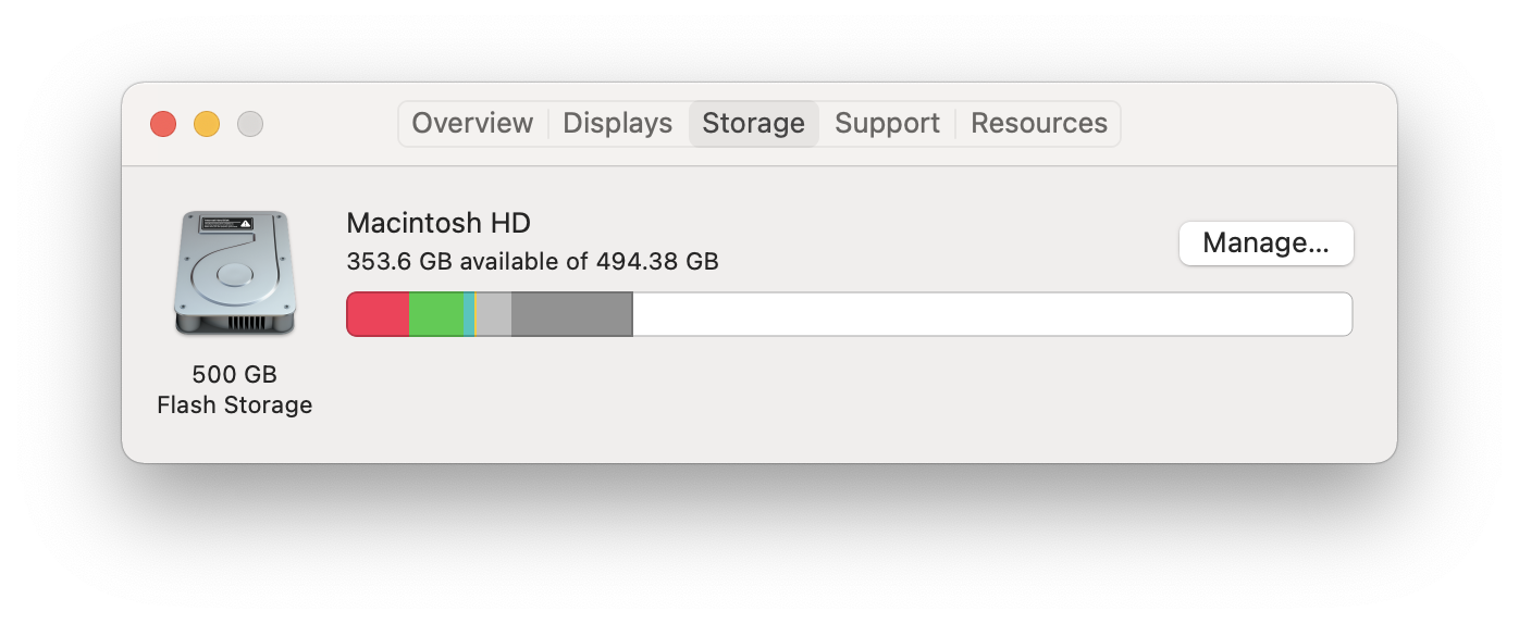

Today, on MacOS 12.2.1, I had to migrate from one MBP 14" to another (needed more RAM so bought an entirely new MBP - same 500GB SSD). This is how much space I was using:
But when I used Migration Assistant, this is what it told me:
~/Library is 467.42GB in size? No way.

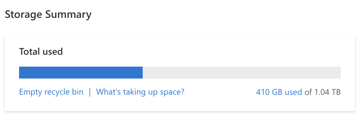

It was only on a hunch that I thought "huh... you know what is about 400GB? My OneDrive account!"

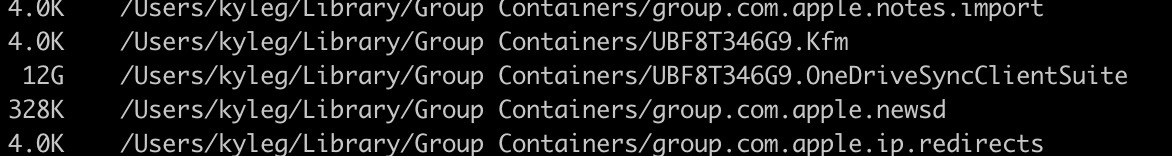

So. To try this out I unlinked my MacBook from OneDrive. Deleted the OneDrive directory. Uninstalled OneDrive. And even, out of an abundance of caution, deleted a 12GB directory I found within ~/Library that had OneDrive's name on it.

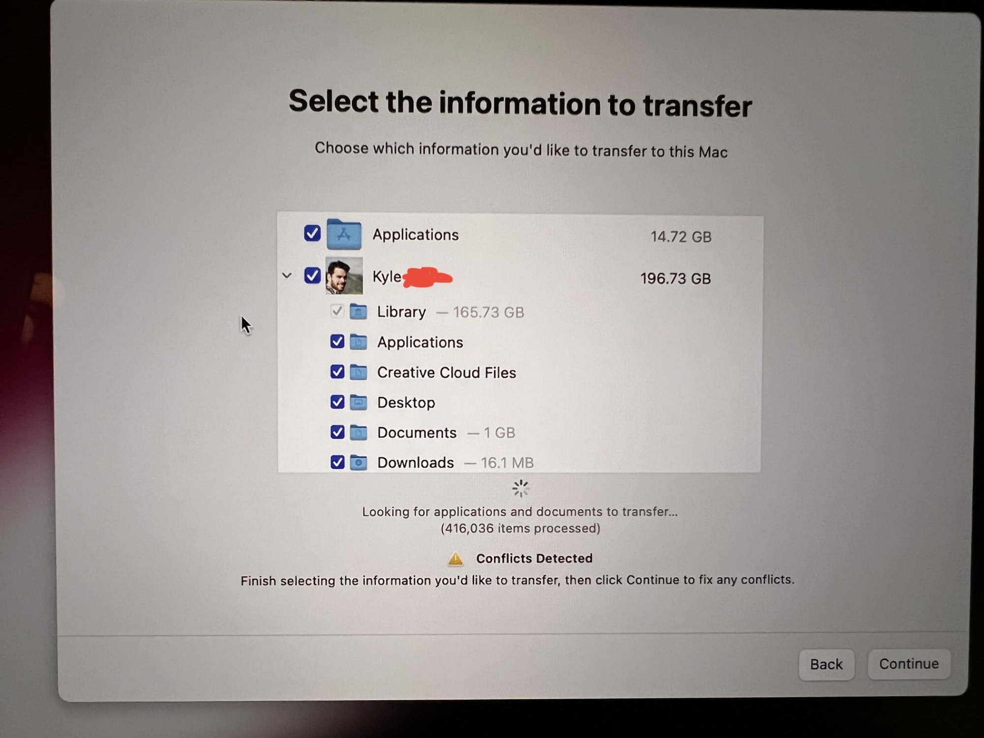

Started up Migration Assistant again. And while the calculated account was still inflated, it was far less inflated (165GB vs 467GB) and I was able to Migrate to the new MacBook!
And yes, even that 165GB was a gross over-calculation. The new MacBook's used SSD was just about identical after Migration.

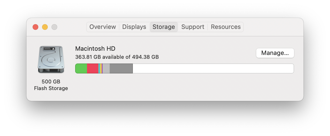

And yes, even that 165GB was a gross over-calculation. The new MacBook's used SSD was just about identical after Migration.View attachment 1963831
